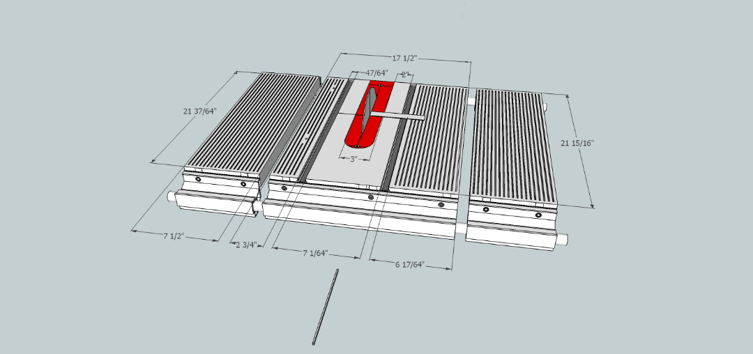

Hi all. I'm away from my 510 right now and could use some help.
Would someone please send me the outer measurements of the table?
And the measurement from the left side of the table to the left side of each miter slot?
Thanks!
Geo
Re: 510 Main table dims
Main Table and Two Floating Tables with dimensions Measurements.png (152.41 KiB) Viewed 1127 times
I hope this will help:
