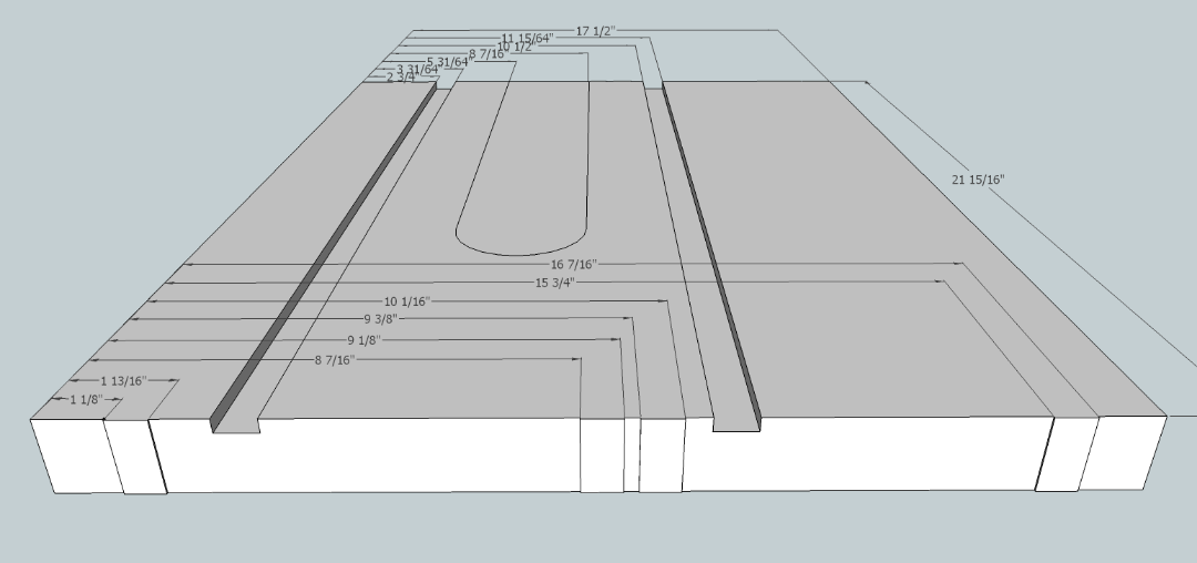

Dusty do you have a similar drawing for the 510 table ?

That is a 510 table.
Re: Dusty's drawings !
It gots 520 rails!jsburger wrote:?????That is a 510 table.
Table itself = 505/510/520.

I kinda got that it was a 510 table but with the 520 rails. It would be handy every so often to have a schematic drawing of the 510 table with the 510 rails as I have three 510's.

Yes it does but there are no dimensions on the drawing that include the rails.JPG wrote:It gots 520 rails!jsburger wrote:?????That is a 510 table.

The tables themselves are the same. That is what the drawing shows, the table dimensions. You asked for table dimensions. If you want dimensions with the rails included that is a different matter.masonsailor2 wrote:I kinda got that it was a 510 table but with the 520 rails. It would be handy every so often to have a schematic drawing of the 510 table with the 510 rails as I have three 510's.

I found this drawing of just the 510/520 table. It contains the dimensions that I most often use when I need table dimensions. It does not include the rails because I have not yet learned how to use Sketchup with round (curved objects). Items like the spacers between the rails and the table have stumped me.
Caution: Use these dimensions at your own risk. My eyes are nearly 75 years old and don't always see so well. I have posted this drawing in the Sketchup archives. Sketchup is free. Download it to your computer and you can pull all of the drawings from there as if they were your own. No restrictions that I know of.
- Baseline 510 Main Table with dimensions.png (57.87 KiB) Viewed 3229 times

Thanks Dusty !

I have put some of my Sketchup drawing up on Sketchup. They can be retrieved from there and used just as if they were put there by you. Help yourself. I do not consider these to be mine. They are to share.
