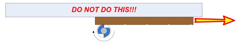

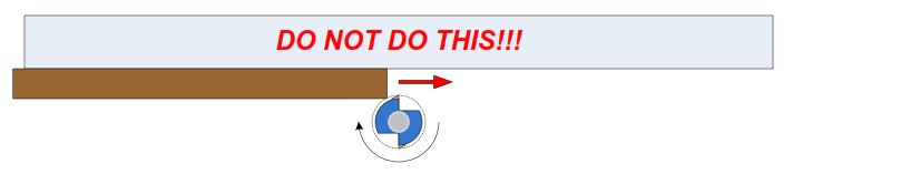

Dusty, I was a bit stumped when you first brought it up .. it's a pretty challenging thing to illustrate. But I thought about it some more this week, and here's my best shot.
First up, here we have a workpiece being fed between the router bit and the fence, in the same direction that the bit is spinning.
Fence trap entry.JPG (17.8 KiB) Viewed 8274 times
The woodworker probably wants to make a cut like this, with the fence-to-cutter distance set to provide a nice uniform workpiece thickness.
Fence trap objective.JPG (17.28 KiB) Viewed 8274 times
But alas, the bit cutters don't cut -- they instead become sharp cleats that bite into the workpiece, accelerate it up to the cutter speed, and fire it across the shop like a baseball-pitching machine. Lets just hope that the woodworkers fingers don't follow it into the bit! :eek:
Fence trap missile.JPG (18.48 KiB) Viewed 8274 times
Now let's say that's a 3/4" diameter bit in the illustration. So the cutting circumference is Pi * 0.75 = 2.36". My PC 690LR router spins at 27,500 RPM, or 458 rev/sec. Thus the cutter speed would be 2.36 in/rev * 458 rev/s = 1080 in/sec. That's a cutting-edge speed of 90 ft/sec, or 61 mph, folks. And that router has ample kinetic energy to fire a good-sized workpiece at very close to that speed.
So what happens if you feed the workpiece from the opposite direction (opposing the cutter rotation)? I have some theories, but I'd like to hear what other people think.

Your illustrations seem to be correct but do not represent what I believe my experiences have shown me. I seem to recall that the work piece was taken away from me and shot across the shop to what would be the left side in these illustrations.
Unfortunately, this is not one of those situations where I am going to run to the shop to get a demonstration.
PS: This discussion gets confusing I believe because I mix up the fine details by discussing under the table routing, free hand routing and overhead routing. At least that is the case for me.
My stated concern was for when working with an under the table router. In that case, bit rotation is in the opposite direction of what is shown in your diagrams and a work piece trapped between the fence and the bit would be shot off to the left.

Your illustrations seem to be correct but do not represent what I believe my experiences have shown me. I seem to recall that the work piece was taken away from me and shot across the shop to what would be the left side in these illustrations. The walk action of the cutter head does not support that recollection.
To be consistent with the earlier slot-mortising illustrations, I showed a top view if routing with a Shopsmith in drill-press mode. With an under-table router setup, the bit rotation would be reversed (from the top view), and the workpiece would indeed be fired in the opposite direction.
