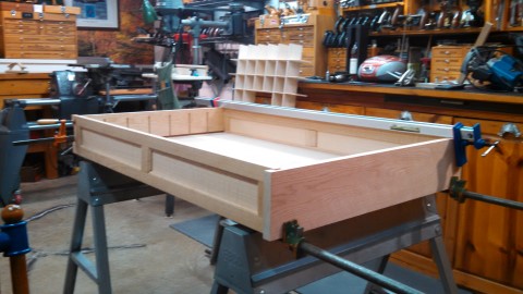

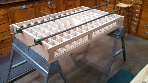

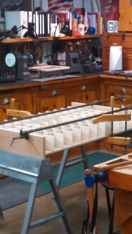

The top and bottom 4/4 red oak was stop dadoed to receive the 1/4 Aspine tops and bottoms. Then it was fitted with sides. I used 1/4" double sided quarter sawn red oak veneer for the floating panels.

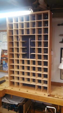

My dear wife wallpapered the MDF with an Air Force blue wallpaper.

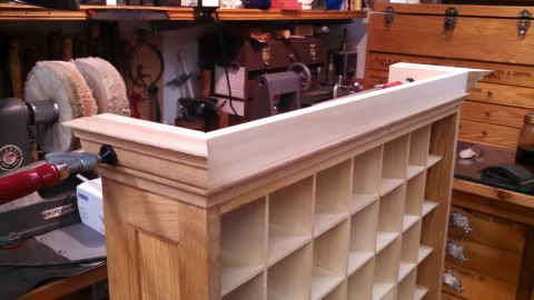

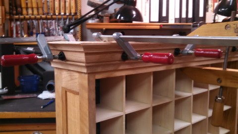

I then created the crown molding. I hand cut using molding planes as well as machined molding using the SS molder to build the crown.

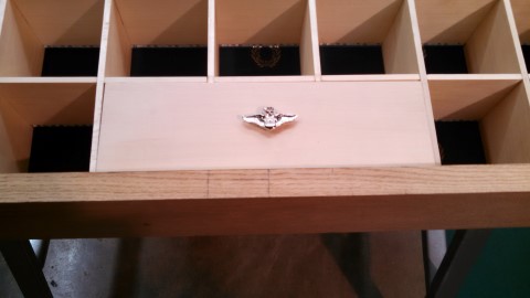

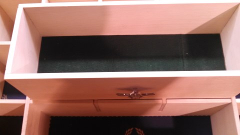

I dovetailed the bottom drawer in 1/4" Aspine with a felt bottom over masonite board bottom. I created a pull from a set of navigator wings, clipping the pins and epoxied a 1/4" oak dowel set in a recess drilled in the back of the wings. Silver, not brass, is the highest ranking metal in the AF, so I used all silver or brushed nickel in the project.

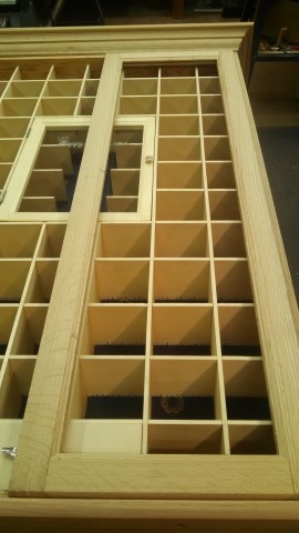

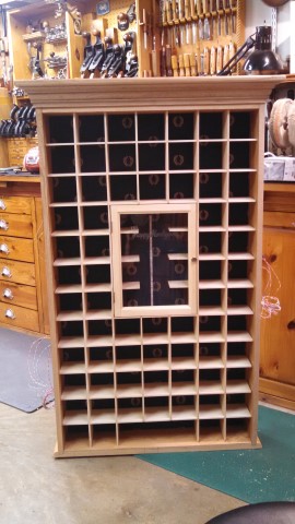

Time to start on the doors.
IMG_20150307_145941_297 (Mobile).jpg (69.21 KiB) Viewed 2741 times
