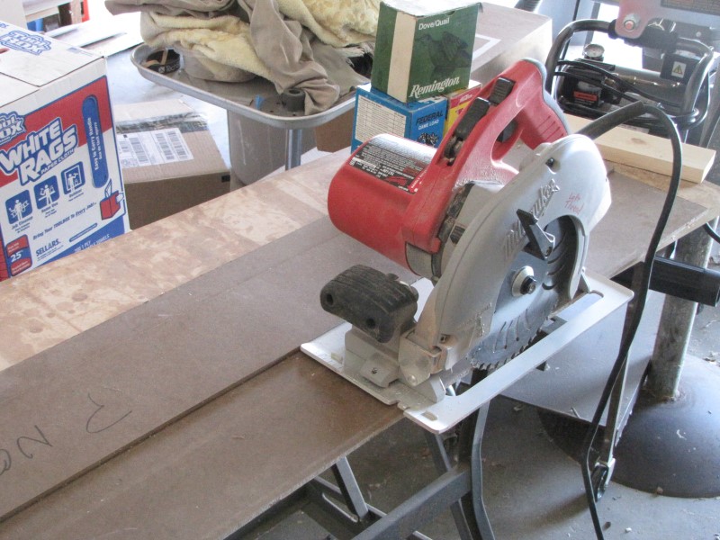

Here's my poor man's version of an edge guide.
I've got 1 that's about 66" long for cutting Baltic Birch sheets and another that's 96" long for cutting standard plywood sheets.

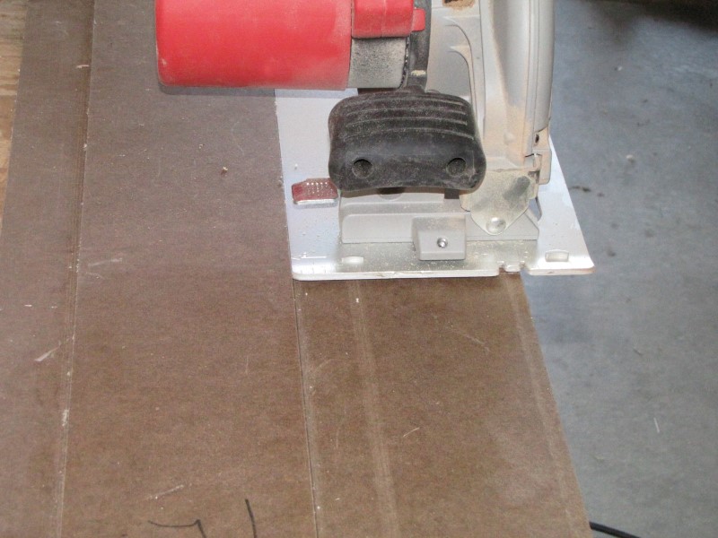

Show face down.

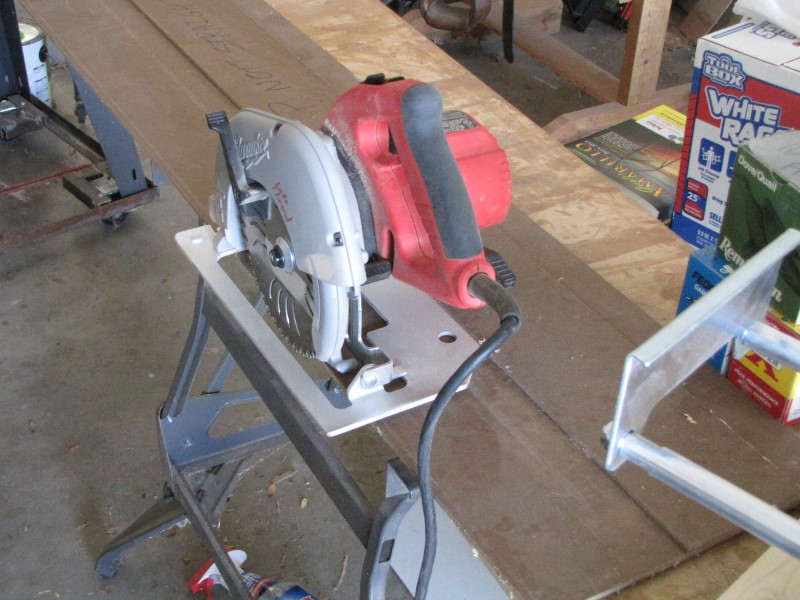

Place the edge guide on top of the 'keeper' piece.

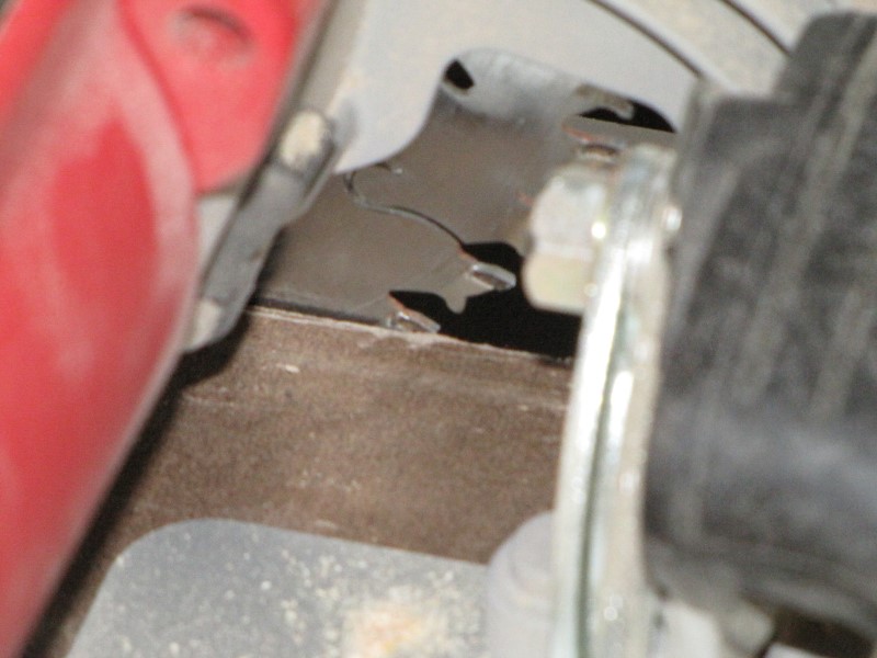

Edge guide is a ZCI for one side of the blade.
Use a good, sharp, appropriate tooth count blade for the job at hand.
Another thing that helps prevent tear-out on the top side is to run a strip of masking tape down the cut line.
Alternative Edge Guide for a Circular Saw
