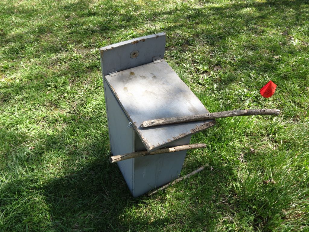

I was able to get it down without any major problem and nothing destructive happened. Here is a picture of it sitting on the ground.
The roof will need some minor repairs, I have learned that they like to chew and by adding some branches they will not damage the house as much as much as they could. A good cleaning and fresh paint are a must.

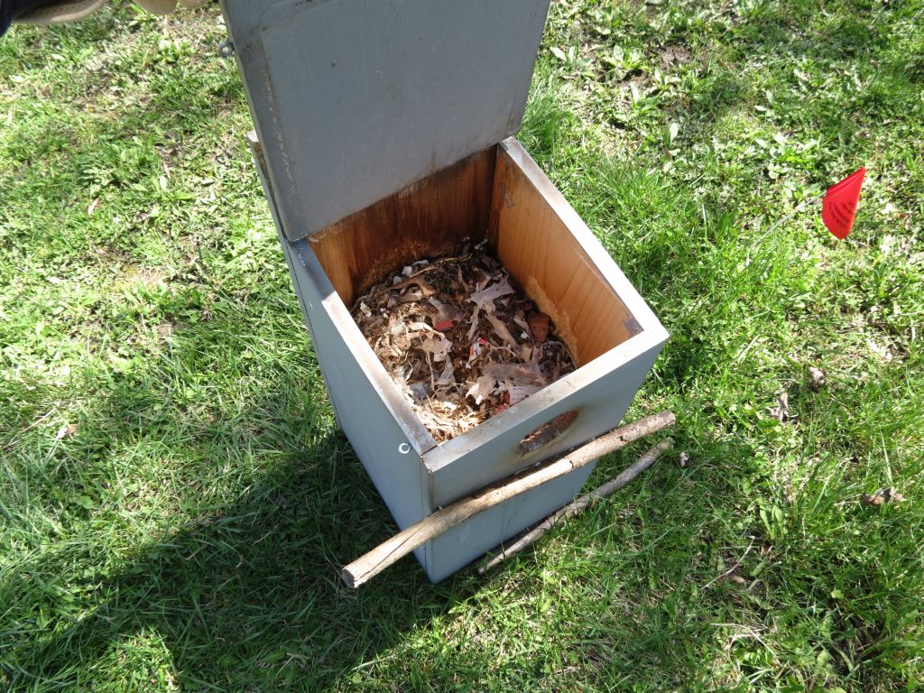

So lets have a look inside.

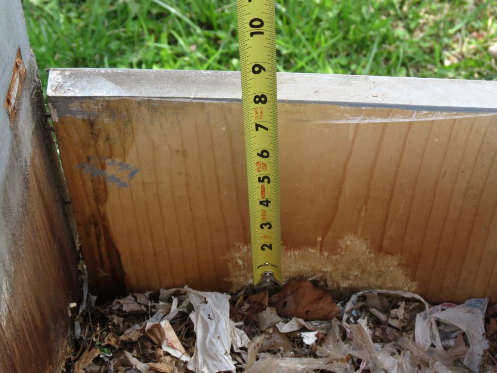

The back wall gets a far amount of water due to the open seam where the hinges are. They also like to scratch the inside, trying to get a bit more space I guess. I have seen them scratch all the way through the wall to the outside. This time that damage is minor. A seam along one side has opened up so that will need repair. All in all it doesn't look to bad.
The house is 24-3/4" tall. Take off the roof and you have 24 inches minus the thickness of the floor or 23-1/4" of height. The box was filled with in 8" of the top!

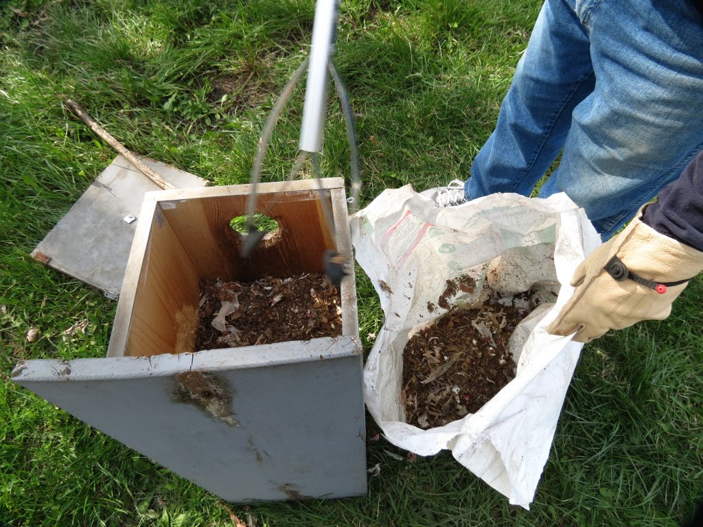

In this last shot you can see the scratching and the open seam. I had used a coated nail in my nail gun to see how well that would hold up. It didn't. Keep in mind the load and weather exposure it would be a lot to expect of a nail joint.

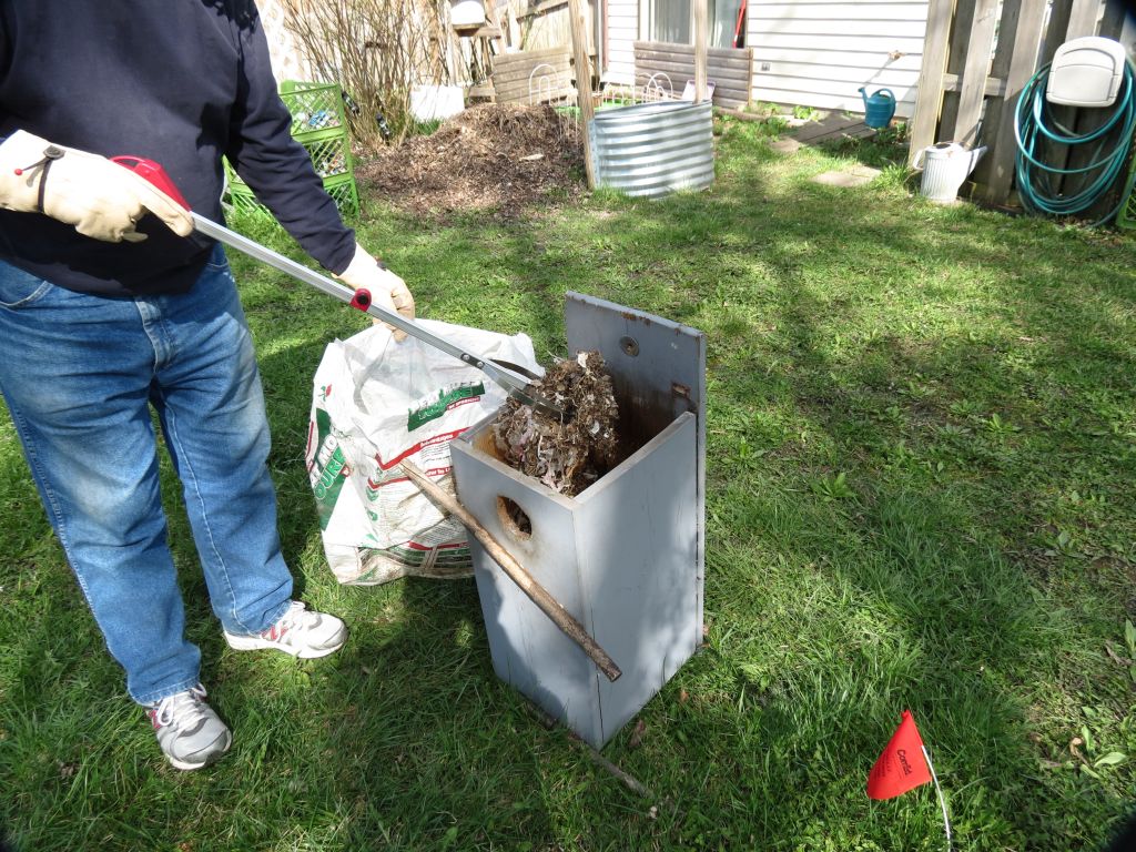

So out with the old.
They had shredded the bags, and it was interesting to see things like gum wrappers and all manor of other human waste that they had incorporated in to the box.
About a foot down in the box I pulled out a squirrel tail. Not far behind was the body of a full grown squirrel. Sorry no pictures of that. No idea what the story on that could be. No particular odor so it must have been dead for a good long time and pretty well preserved by the leaf particulate. This was a first for us, never before I have we found a dead one in the box. It was also interesting on how much plastic had been found and used. Back some years ago we never found plastic in the materials.

I don't see any evidence of them chewing on the painted surfaces but I don't think I would paint anything that was intended to house wild animals (birds, squirrels, etc.). The animals don't know the difference as evidenced by all the man made stuff you found in the nest and it could be harmful to them.

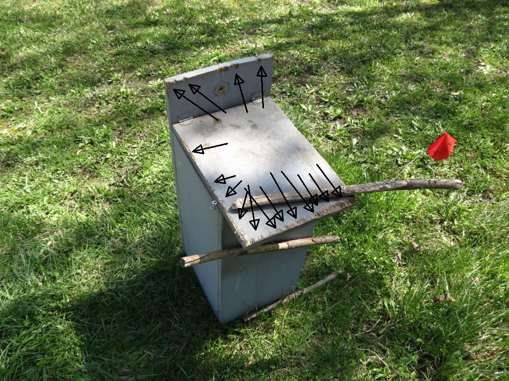

I think it must have been a couple of years ago that I posted information on this project. I'll have to see if I can find it. As I recall I had a link to the plans posted. I don't know if anyone else has built one but they are simple to do for any skill level. I would encourage anyone interested in build one of these or any other animal boxes to do so.
The roof of this design is the weak link as far as chewing goes. Well that and the vertical that attaches to the tree and where the squirrels like to hang out. The young ones especially like to find something to chew and the edge of the roof is a favorite due to it being so close. Below you can see a picture of the highlighted chew locations.
I don't think it needs to be replace this year. From past experience these house last in the 4 to 5 year range. So with that in mind I think I will do the minimum needed to the house and hope of the roof to last another year or two or three.
