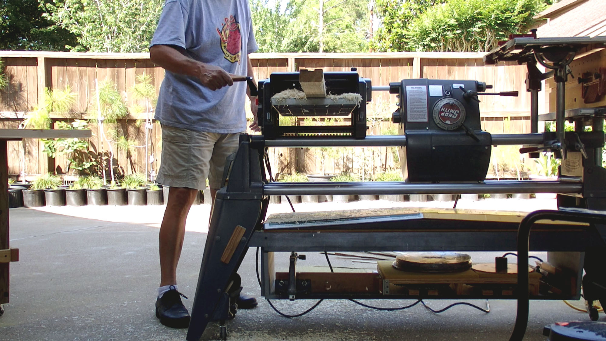

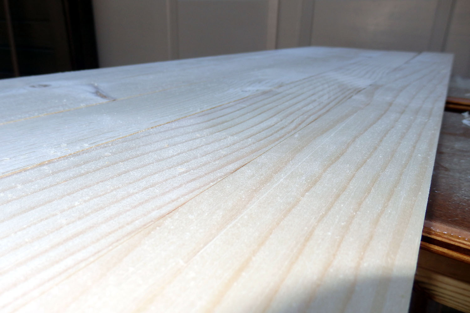

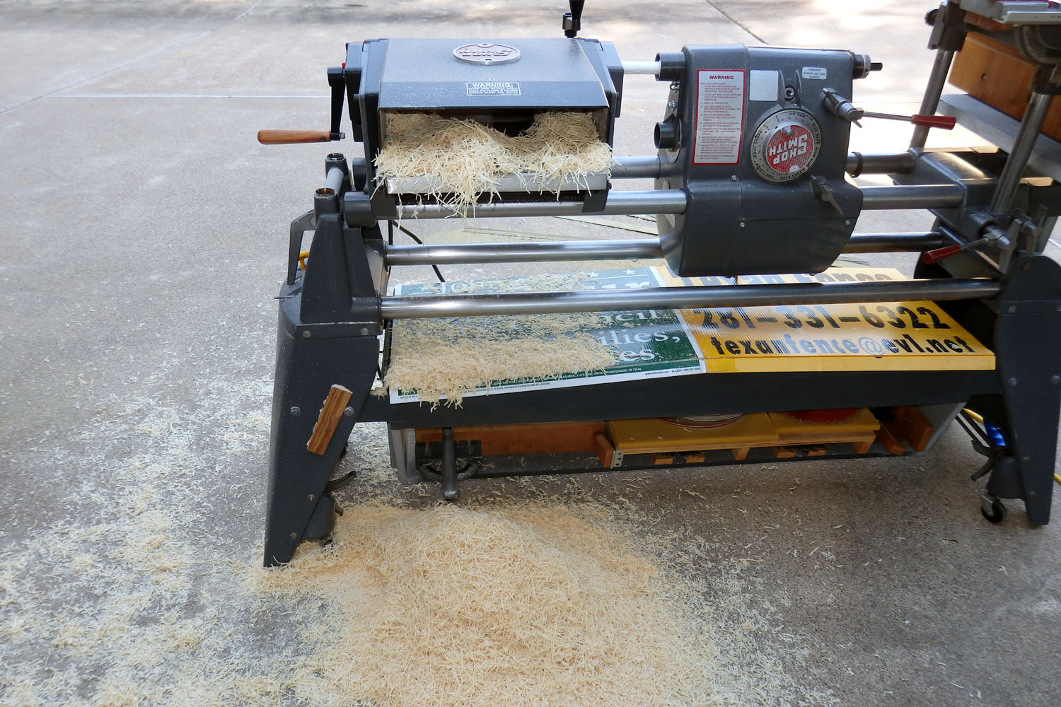

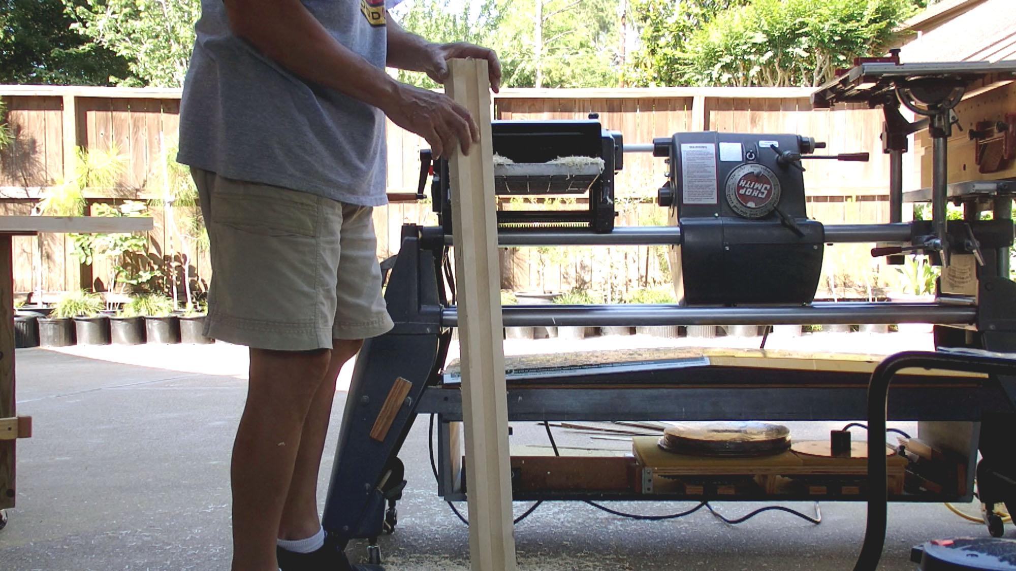

A long overdue update. It has been over a year since I converted my planer to manual feed, and finally the stars aligned for me to try it out. I had picked up some very nice white pine dunnage boards at Home Depot a while back and used the planer to remove the dado for the metal strapping. This was my first time of operating any type of planer, and I can see much more in my future as it worked well and surprisingly easy. Cranking the feed handle was kinda like an old mimeograph machine ... easy to turn, and less than a minute for each pass. It wasn't until I was nearly through that I realized I had forgot to clamp the planer to the way tubes, but with the headstock locked and the planer butted up to the left end, it didn't seem matter. Now that I have my first bucket full of shavings, next up I will challenge the planer to some hardwood. Many thanks again to Dusty, JPG, and others for their help and encouragement.

Well done and congrats on the innovative solution! Those boards look great! I really like the idea of manual feed because you can adjust your feed rate and finish quality.
nothing like a pile of planer shavings! :)
