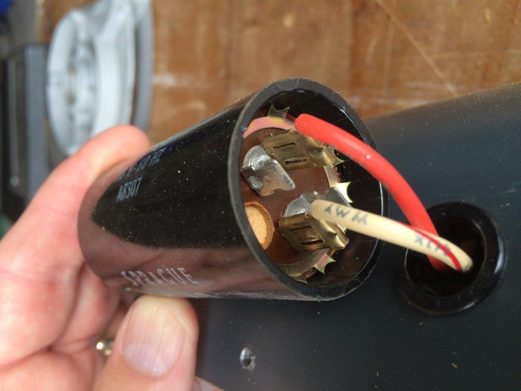

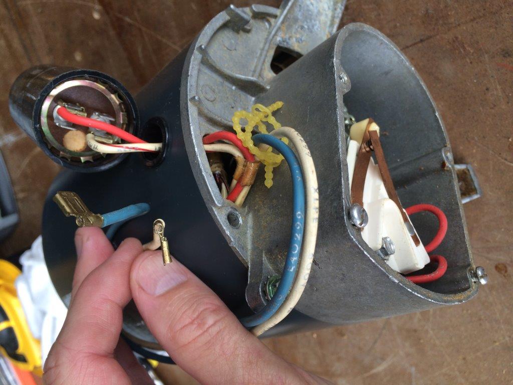

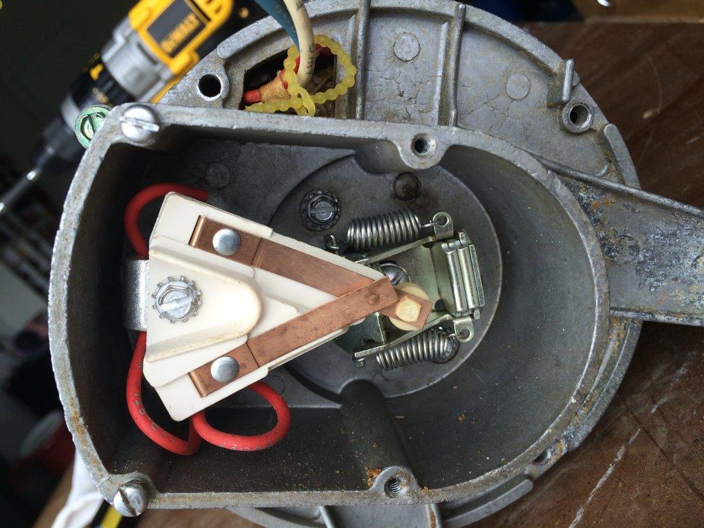

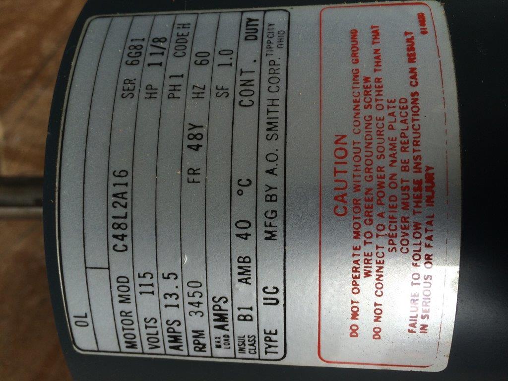

Hi All,
I am restoring an 1981 Shopsmith Mark V into a Shorty to drive my Jointer and Bandsaw. I need a litle help to make the motor reversible so I can leave the Bandsaw on the quill side of the motor. I have an AO Smith motor but the wiring doesn't look to me to be same as I've seen in the diagrams.
There are Blue and White wires coming down from the switch and Red and White wires going to the capacitor. I didn't do anything with the centrifugal switch to see what's behind it. Can you help me make sense of identifying the starting coil and running coil wires and which I'd have to switch to make it reversible? Below are some pictures of the unit.
Thanks!
Nameplate info.
Nameplate info.
Switch Wires
Switch Wires
Capacitor Wires
Capacitor Wires
Centrifugal Switch
Centrifugal Switch
