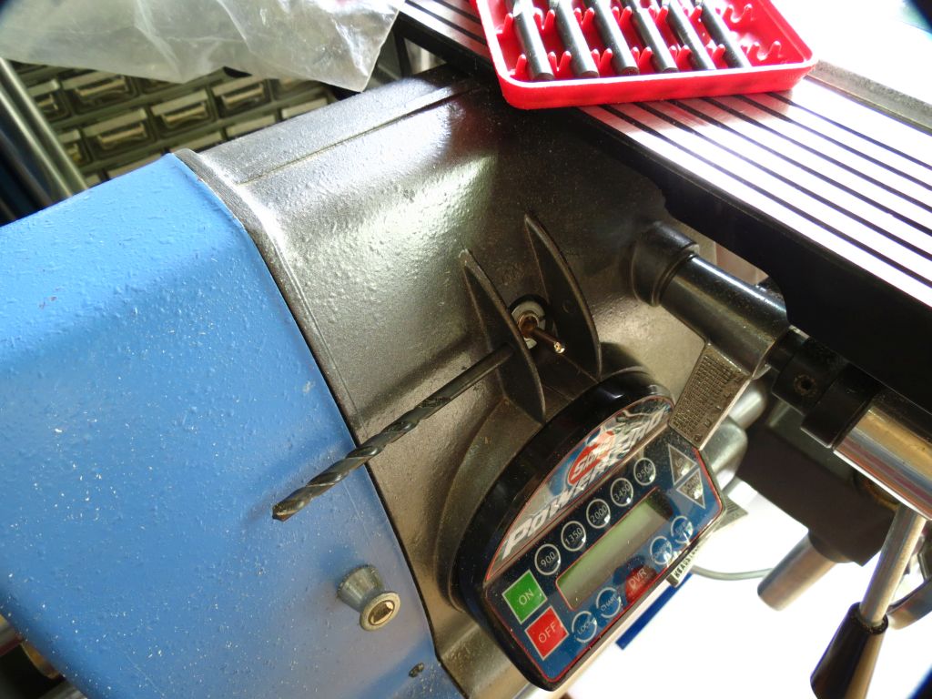

And, no it will not fit. But when I measured the lock it looks like it would slip in a 1/4" hole.
Using a drill bit to measure, mine at least looks to be 7/32.
If you wouldn't mind drill the hole on yours 1/32" larger then it may open the world of locks for this purpose.

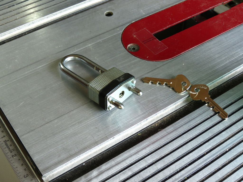

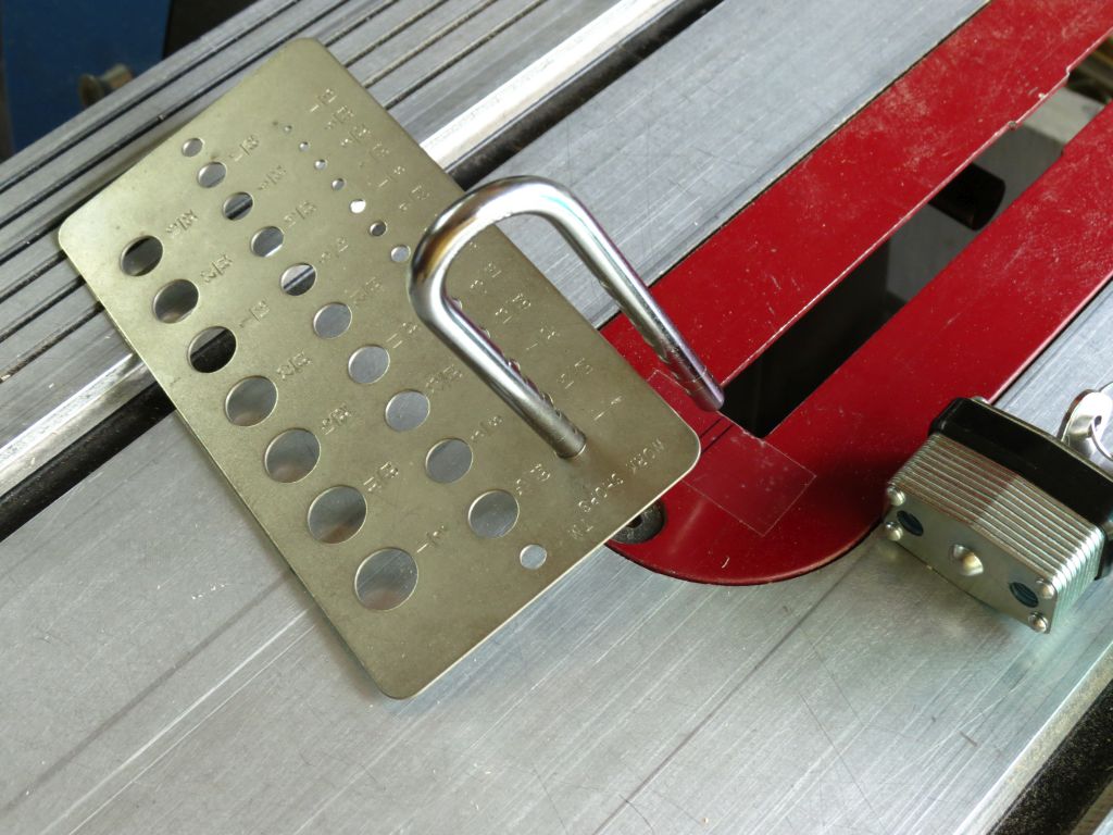

I have three headstocks with the toggle switches and the holes for the padlock. I like the padlock idea better than the cord lock for a number of reasons. Per Ed's measurements above, I believe mine are also 7/32". Which is why the 517D that JPG mentioned above won't work (shackle is too thick if you read the specs; I also happen to have one and double-checked).
Didn't find anything on the Master Lock site under "Home & Personal", but did find a good candidate under "Business & Industry". The model 7LJ (link below) and related models (they have a brass one for corrosion resistance, if that's your thing) sport a 3/16" shackle diameter, and the shackle itself is 2.5" long. Hopefully will be a perfect fit like the locks the MS used to sell? I don't think you can order directly from Master Lock, but I found a reasonable deal at http://www.mrlock.com (~$7 + ~$5 shipping).
I will report back on how it works, with a photo, once I receive it. If it works, I'll be ordering a couple more for the other headstocks.
