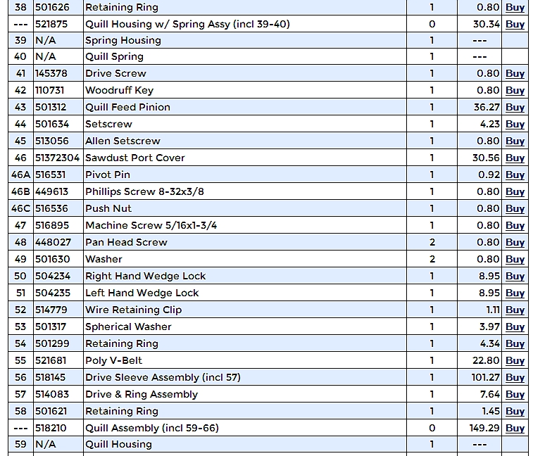

What is the difference between a 10ER and a MK V quill return spring?

jsburger wrote:I have not looked but is the MK V spring available from the mother ship? Maybe that is the issue.
You can buy the spring, BUT you get the whole assembly with it.
#59 here http://www.shopsmith.com/service/headst ... s_list.htm
Re: SS Quill Return Spring
Hmm... #59 is the quill housing which is N/A. The spring is actually #40 and is also N/A. The spring housing is #39 and also N/A. But you can buy the two together P/N 521875 for $30.34. That is not too bad if one is desperate and the spring will actually work on a 10ER.beeg wrote:jsburger wrote:I have not looked but is the MK V spring available from the mother ship? Maybe that is the issue.
You can buy the spring, BUT you get the whole assembly with it.![]()
Thanks for pointing in the right direction.

beeg wrote:HMMMMM. Wonder WHY there's a gap in numbering. But at least it got ya what ya needed for part of the question.
What gap
The quill housing and spring are a sub set of the entire quill assembly. Somebody lost track of details/heirarchy!
I think there is an error in the parts list. If you look at P/N 521875 at the top of the list it says "Quill housing..." It should say "Spring housing..."JPG wrote:beeg wrote:HMMMMM. Wonder WHY there's a gap in numbering. But at least it got ya what ya needed for part of the question.
What gap
Bingo!!!!jsburger wrote:I think there is an error in the parts list. If you look at P/N 521875 at the top of the list it says "Quill housing..." It should say "Spring housing..."JPG wrote:beeg wrote:HMMMMM. Wonder WHY there's a gap in numbering. But at least it got ya what ya needed for part of the question.
