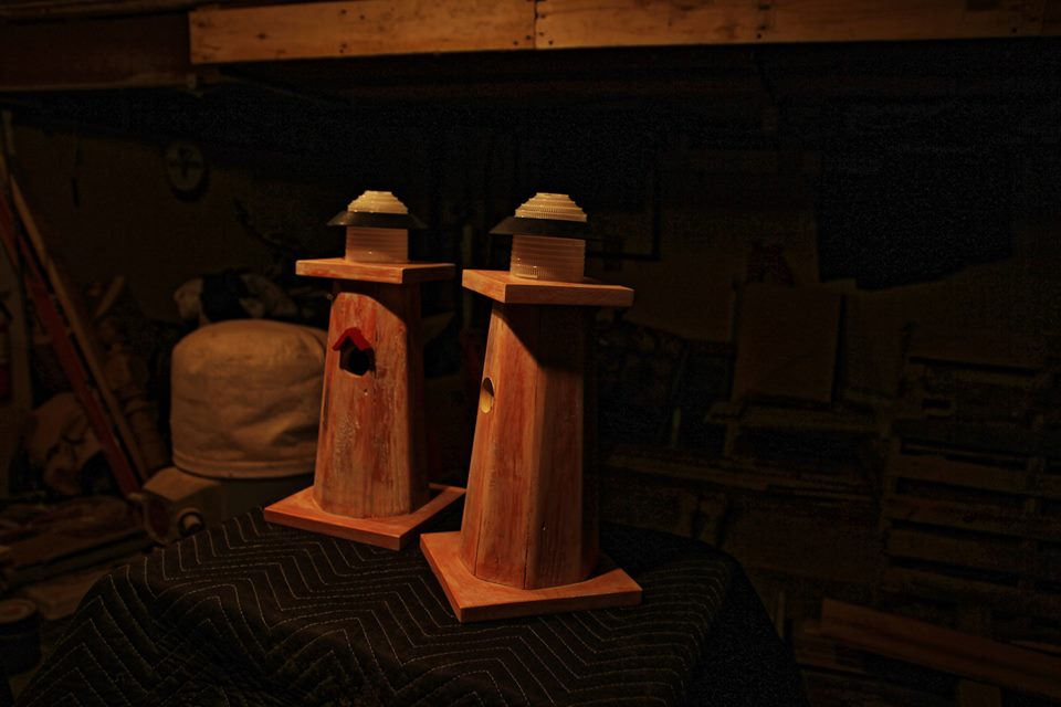

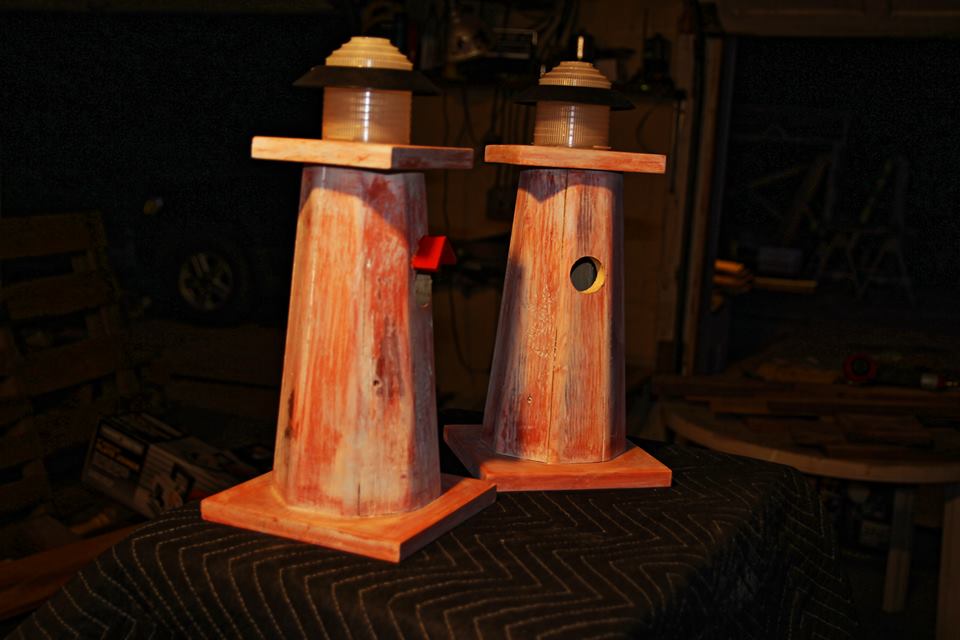

Edit: these cylinders are now, lighthouses
All done cept for figuring out a light source. I think I will use a solar powered LED walkway light! And yes, I decided to bore a 1.5 inch hole, 7 inches above the floor, for Eastern Bluebirds.
Additionally, these received a dry brush treatment of white/red and a light sky blue, to give them a patina.
- temp1.jpg (62.92 KiB) Viewed 8810 times
- temp2.jpg (59.96 KiB) Viewed 8810 times

Re: Lighthouse
What did you use on top of the lighthouse? Looks like something plastic but is it something sold for this type of project?
Thanks
Thanks
