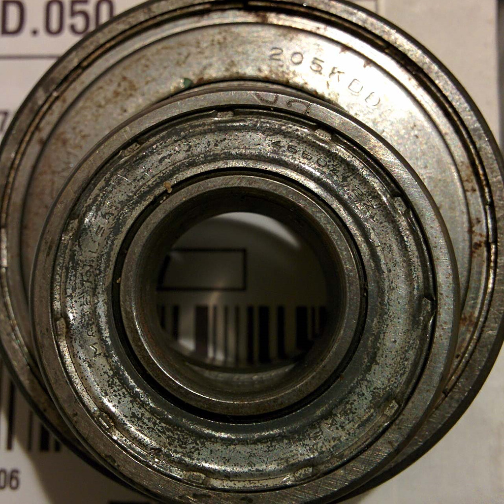

Opened up 1959 Greenie for inspection/repair.
As shown in attached, Drive Sleeve Assembly (Gilmer) used 205KDD (background).
However, it is hard to see the model for Quill (single bearing).
Could anyone confirm please?
