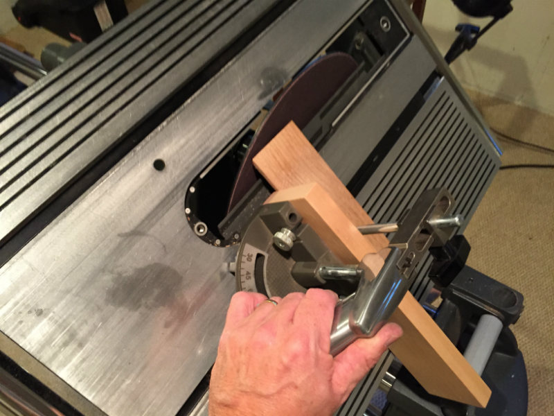

To true-up and exactly length-match the rough pieces, I move to the Disc sander with tilted-table, running it almost silently at 900rpm on the PowerPro:

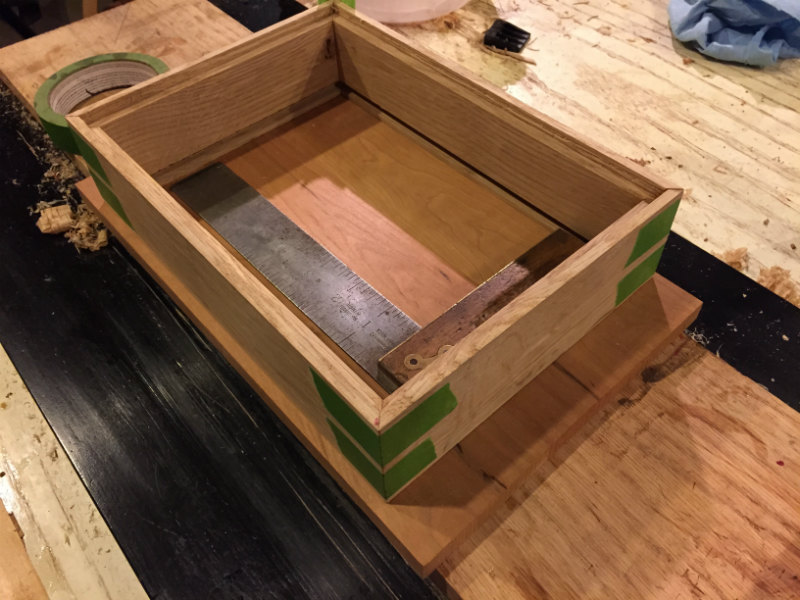

Then I can glue-up 2 joints at a time, leaving myself an opportunity to insert the box-bottom after initial joint-squaring has been established. I just use tape to "clamp" these parts. Later my box-bottom will be plywood-based so I can glue it solidly and have no worries of this box ever coming apart:

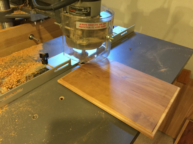

Here, a years-old dumpster-dive piece of cherry cabinet facing is cut to size, rabbeted on the bottom, and later profiled on the top surface:
OPR Cherry Rabbets.jpg (96.7 KiB) Viewed 4580 times

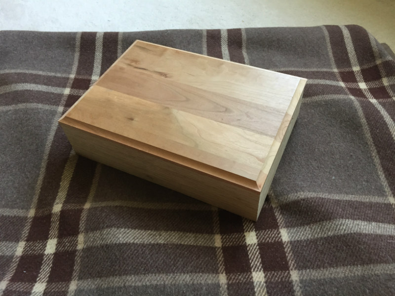

Here is how it will look when lidded:
Mitered Box Closed.jpg (108.7 KiB) Viewed 4580 times
