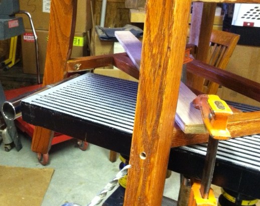

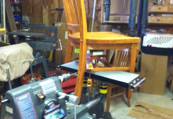

Once again the versatility of my Mark V has come to the rescue. I had a situation - a drilling action I wanted to do - but it was hard to figure a method to do it accurately. Knowing it couldn't be done with a hand held drill, I wondered how to do it with the Mark V.
This was all about a re-finishing job on an old oak library type chair. (BTW it was made and dated in 1941.) The top of one leg had pulled apart from the crest, so I knew there was a bind somewhere. After disassembly, cleaning, adding new dowels, it all went together well except for the rear of the stretchers. This resulted in not real tight dowels from the rear legs to the stretchers. Ah Ha! I found the source of the stress that caused the separation of the crest from a leg.
O.K.! now I wanted to re-enforce that stretcher/leg joint. After deciding a smaller dowel through the leg and stretcher would probably do the trick. The question was how to drill it accurately.
The rear legs are at an angle to the stretchers and the whole heavy chair would not fit on the main table.
Solution -- lose the main table and use the auxiliary table and a couple of clamps. Was able to use the adjustable stop collars on the aux. table for the correct height.
Wow! almost any weird shaped of stuff can be drilled with the Mark V.
extra dowel holes 2.JPG (85.71 KiB) Viewed 4739 times
extra dowel holes 1.JPG (86.07 KiB) Viewed 4739 times
