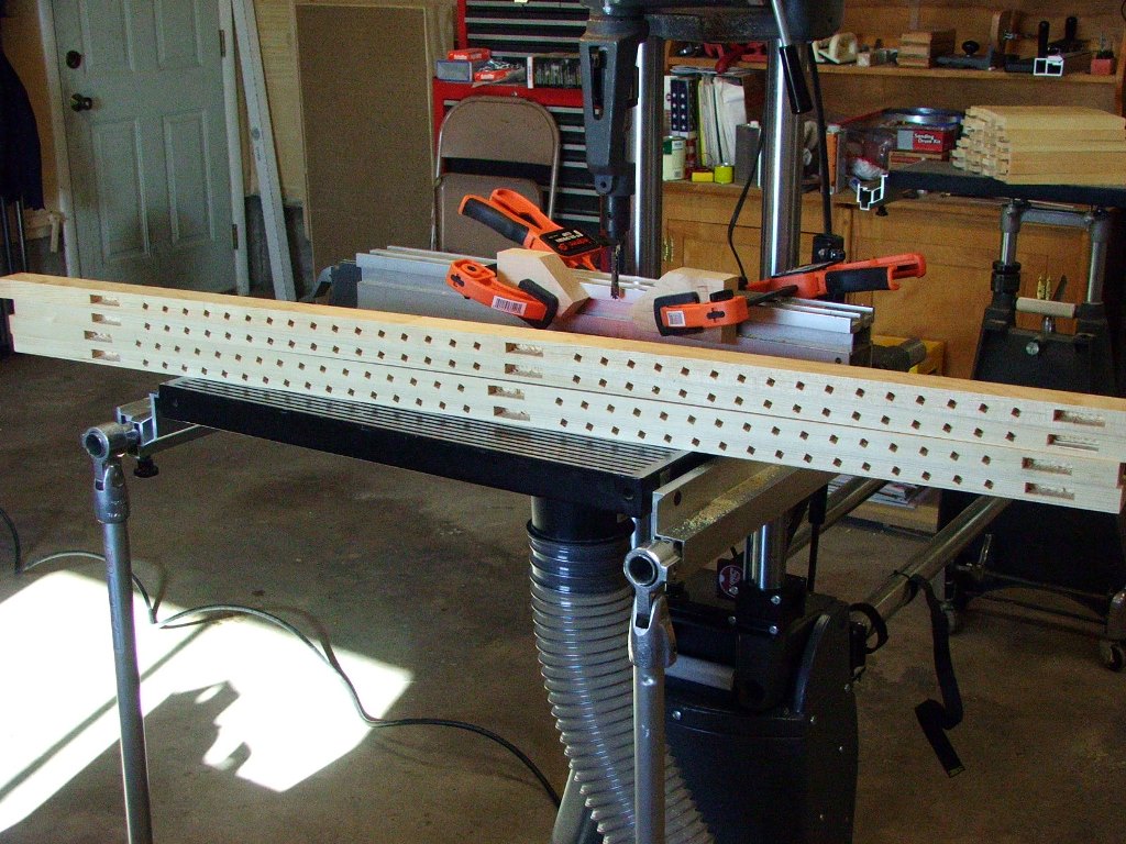

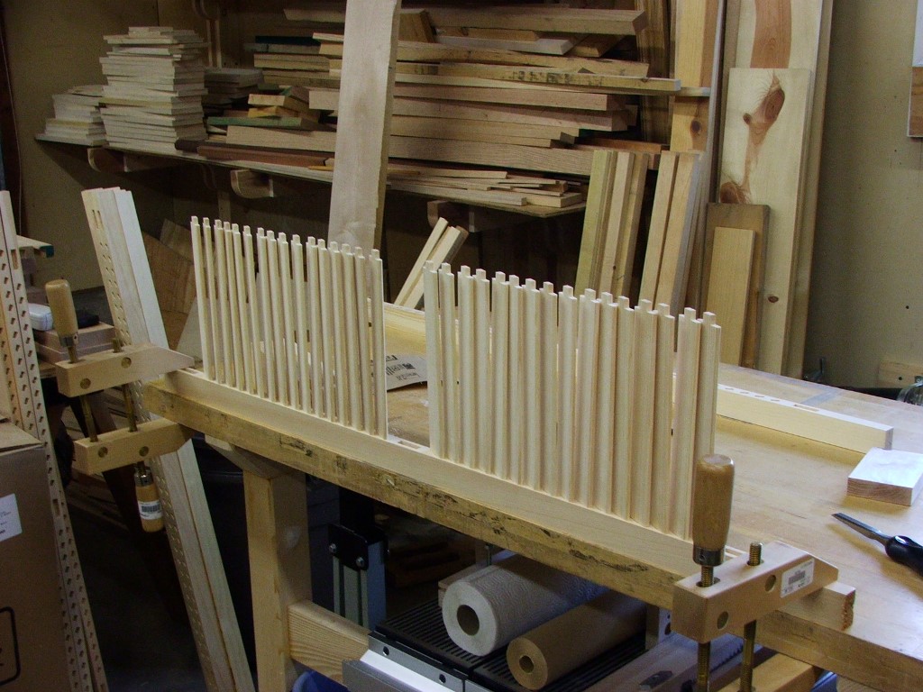

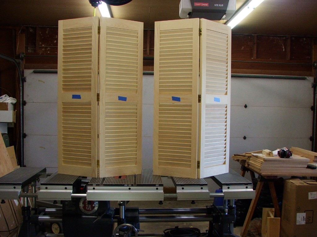

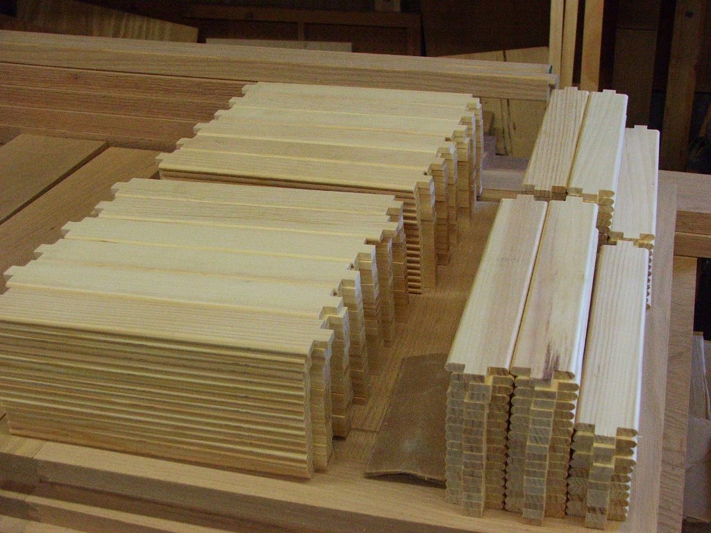

There should not be too much stress on the SS. The only issue is the possibility of downward table creep and that is preventable. I made two sets of shutters for a friend using both the 1/2" and 1/4" mortising chisels with no problem. The picture only shows one set. There was another set exactly the same. Also in the picture of the stiles only half of each 1/4" mortise is cut. They were made out of pine and had hundreds of mortises.

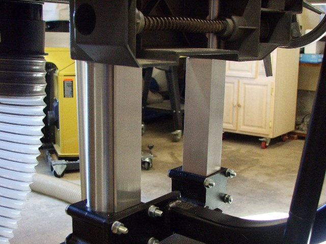

First is make sure you have sharp chisels. A lot of tools (including the SS mortising chisels) are not sharp out of the box. With a dedicated mortiser you have a beefy machine with a long handle and lots of mechanical advantage. You can brute force dull cutting tools and maybe not notice. Not so with the SS. I supported the front of the SS table with the telescoping legs and the table carriage with two pieces of aluminum angle iron set around the way tubes.
I certainly would not hesitate to use the SS for your project.
