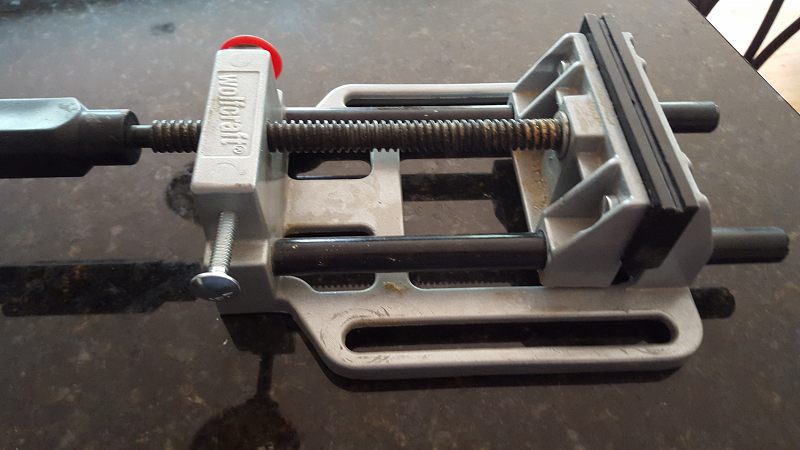

I have a combo vise very much like the older model sold by Shopsmith. It didn't take long until either
1) I tried tightening it too tight
or
2) The faulty design showed its colors
or
3) Both
What happened is quick release would no longer lock and the vise could no longer be tightened. I took it apart and the amount of wear seemed minor, so I believe it is/was a bad design.
What I did was drill and tap for a 1/4-20 screw to firmly hold the internal mechanism against the screw, and now it tightens fine. A couple twists of the screw and I have quick release again. After positioning I run the screw finger tight, and then tighten the vise. Not a perfect solution, but much better than throwing the thing away.
I don't know if similar issues plague the Shopsmith model, but I thought I'd post anyway.

Since taking the photo I've replaced the screw with one compatible with the ubiquitous Shopsmith allen wrench.

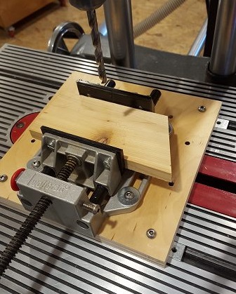

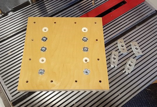

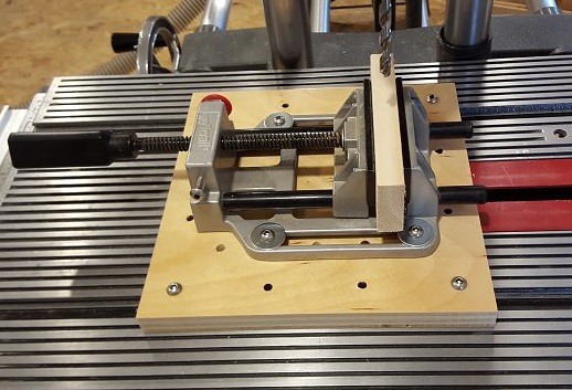

Okay here is my take on the sliding vise sled. I put the miter mounting holes 7.75" apart in both directions so the sled can be mounted vertically or horizontally. I also put multiple mounting points for the vise so it can be moved fore and to center material under the drill bit.
When possible, I like to make jigs on my CNC, that way I can quickly remake it or modify it as needed.
Bottom side after milling on CNC and adding t-nuts: With vise jaws vertical:
With vise jaws horizontal:

Additional holes "for future expansion" as need be.
