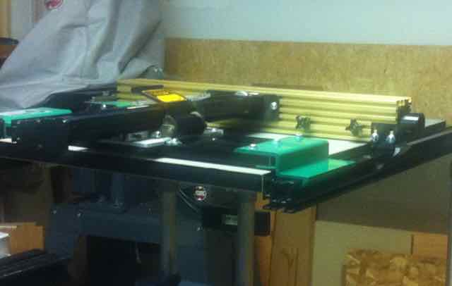

1251 image is how the Jointech fence is attached to the SS 500. As you can see the Jointech conversion required the addition of Jointech rails on the SS, which means you cannot use the the SS rip fence anymore on your main table. I used a 2nd main table to use the rip fence for drilling or angle ripping. The Jointech system came with three floating tables which together with the router table gave me a great work area.

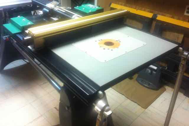

1248 & 1247 images show how I plan to use the Jointech system with the 520 SS as a router fence, if I can’t use the Jointech fence with the 520 rails.
