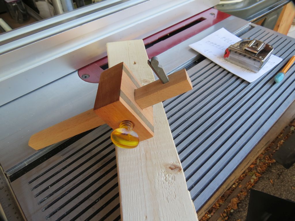

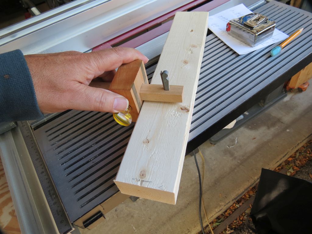

So I'm working on a project today and was about to do some marking with my cheap marking gauge. Here is a picture of it:
In this case I wanted a line down the middle so I could mark hole locations along it. One would find the center then drag the gauge along to make the mark in a fashion somewhat like this...

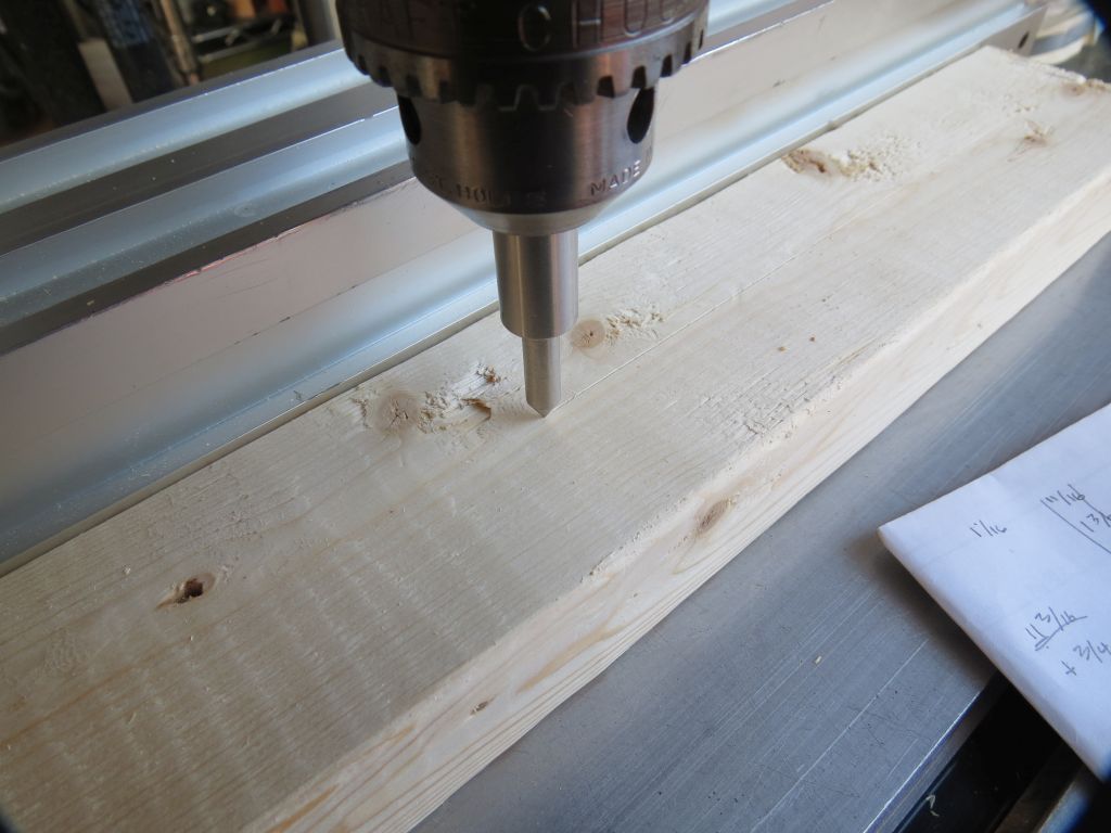

I also wanted to locate the center of the work piece using the rip fence on the shopsmith so I could drill the holes. Since I was setting up to do that using a pointer anyway I then thought how cool would it be to use the shopsmith as a expensive marking gauge.
By adjusting the quill so it was just able to be still moved I adjusted the depth to what I wanted. Now it was simple to slide the work piece along the fence and get my marking done.

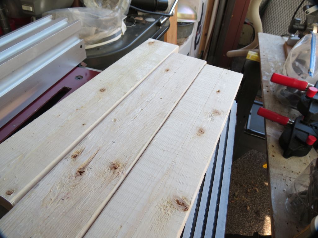

Did the other two pieces and so it happened that a shopsmith became a marking gauge.
It also lived happily ever after, so that is the story of this post.

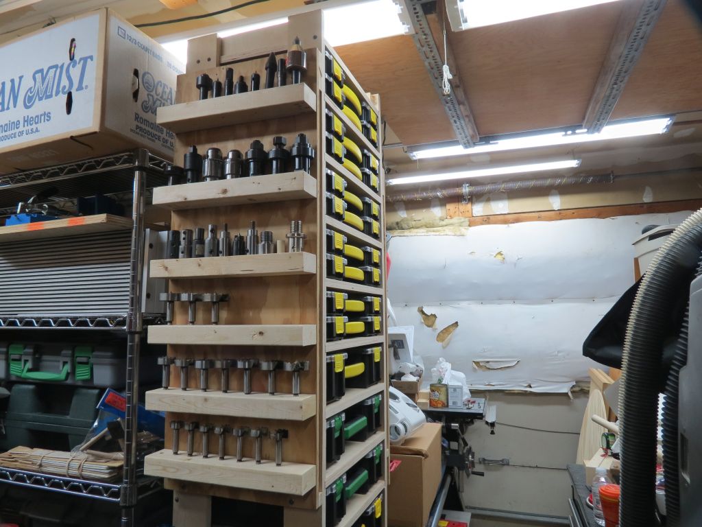

I've been reorganizing a few things in the shop and this is part two of a four part effort. The parts cabinet I built and showed last year and this year I've been adding french cleat boards to the sides (2 per side).
This is all scrap wood and that is fine as I'm in it for the utility rather than the looks. It will be left natural at least for now, it would be more work to fill/sand/paint then I feel up to.

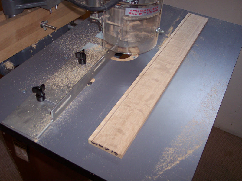

Regarding your marking-gage, reminds me of the "$500 scratch-stock" I once used to put a tiny groove on a machinest-chest drawer facing:
Slitting with OPR.jpg (99.08 KiB) Viewed 3461 times
