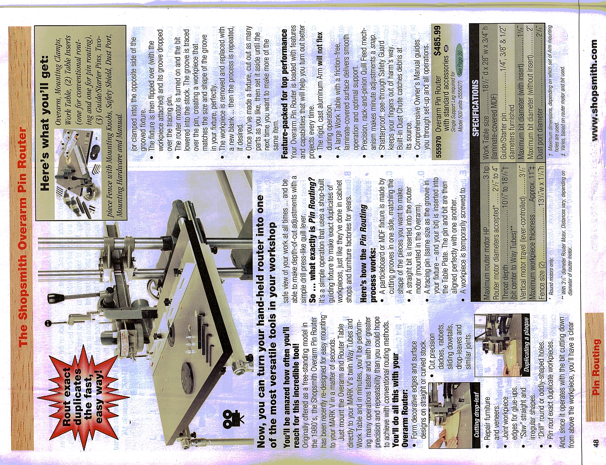

... This help?
OPR 2008.jpg (1.22 MiB) Viewed 4494 times
FATHER'S DAY 2008 LAST ONE I GOT.
NOT THE STANDALONE ONE.

stephen_a._draper wrote:I am looking for a Christmas 1987 or later Shopsmith catalog that shows the original Overarm Pin Router with the wooden table along with stock numbers and accessories. It is pictured in the Fall 1987 Hands On Magazine on pages 8 and 9.
Here is a scan of the page from the 1993 catalog.

Re: Overarm Pin Router
This is still listed as an order-able item.
http://www.shopsmith.com/ownersite/item ... tem=845144
This the Router Arm Manual I mentioned above.
