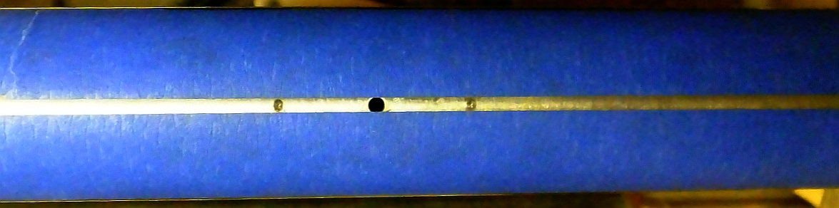

You should have a mark on both sides away from the original center rivet hole. Carefully dimple each location with a center punch. Since the way tube is round, care must be exercised to make sure the dimple is properly located. I find that progressively deeper small 'licks' will allow one to shift the location as the dimple is gradually made deeper.
1,2 marked.jpg (237.38 KiB) Viewed 8150 times
Repeat for the other 'half'.

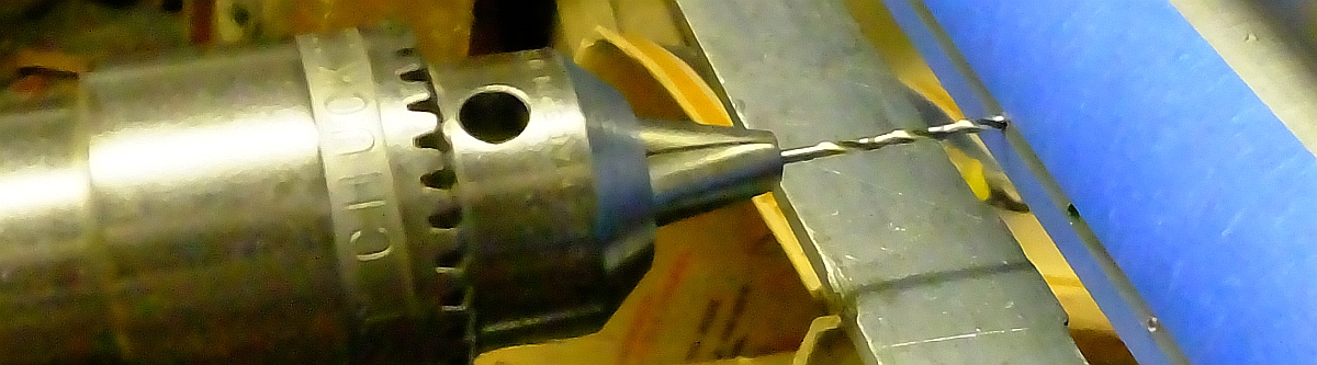

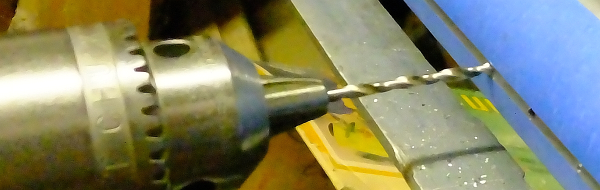

Now for the dicey part. I located the table top 7/8" below the drill bit center. Then used the rip fence to back up the way tube. I manually positioned the way tube horizontally to place the dimple directly in line with the drill bit. I used the smallest bit the chuck would securely hold to drill a pilot hole. It is quite easy to break a bit unless you hold it all very tightly. I find that clamping does not allow me to make minute position adjustments. The drill bit will let you know the way tube needs tweaking without breaking. A product of much practice. ;)
pilot hole.jpg (307.47 KiB) Viewed 8142 times
Repeat with a 1/8" bit. I originally drilled 0.120 holes, but could not locate any pop rivets of the original size(3mm I believe). So eventually the holes were enlarged to 1/8"(manually).
final size.jpg (343.22 KiB) Viewed 8142 times
Holes drilled
1,2 drilled.jpg (461.7 KiB) Viewed 8142 times
Repeat (again).

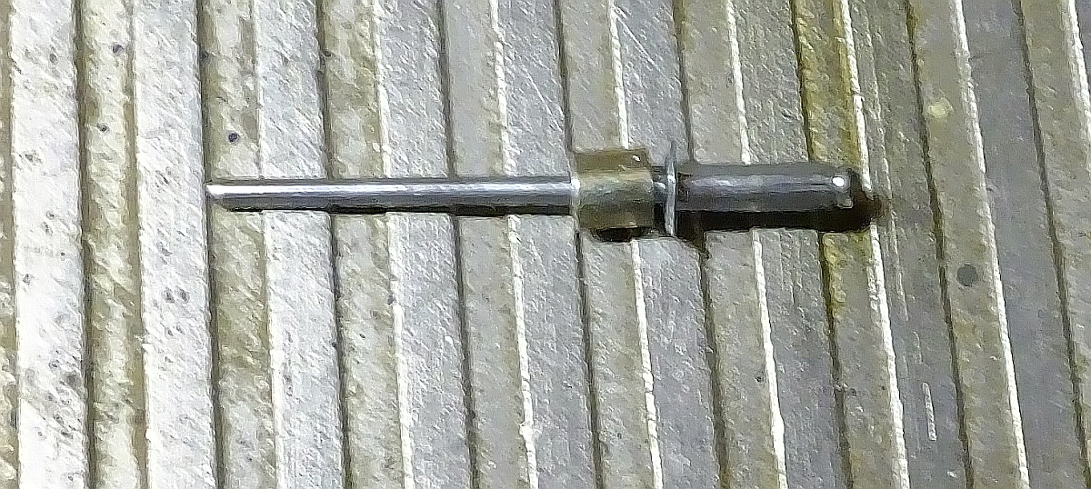

Now for the other shoe. The pop rivet heads are 1/4" od and the new piece holes are 0.200(matches the original(again)). So, they need to be 'resized'(fancy word for filed down). Slow with frequent measuring will get them down to 0.198 to 0.200".
RESIZE RIVET HEAD.jpg (760.01 KiB) Viewed 8142 times

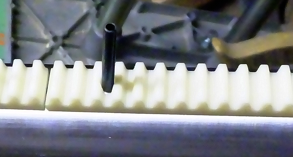

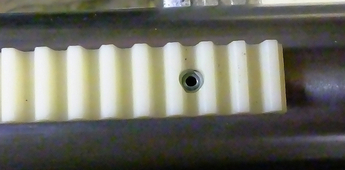

Moving on the the next 'issue' is the rivet head must be recessed into the rack. So a spacer is needed that will fit into the rack 'counterbore' and longer than the bore is deep.
From the miscellaneous jun. . parts jar.
RIVET SPACER.jpg (615.9 KiB) Viewed 8142 times

Hokay, we are now ready to actually mount these suckers! [Almost]
I think that seating the pop rivet firmly in that counter bore is cheap insurance to guarantee the pop rivet will not stray as the other end is being 'swaged' by pulling on the center pin. So another trip to the hardware store for a pair(only one needed unless you lose one) of these 'rivet sets'.
RIVET SET.jpg (679.92 KiB) Viewed 8140 times
Used to tamp the rivet down to the bottom of the bore(in the new rack piece).
TAMPING RIVET.jpg (587.42 KiB) Viewed 8140 times

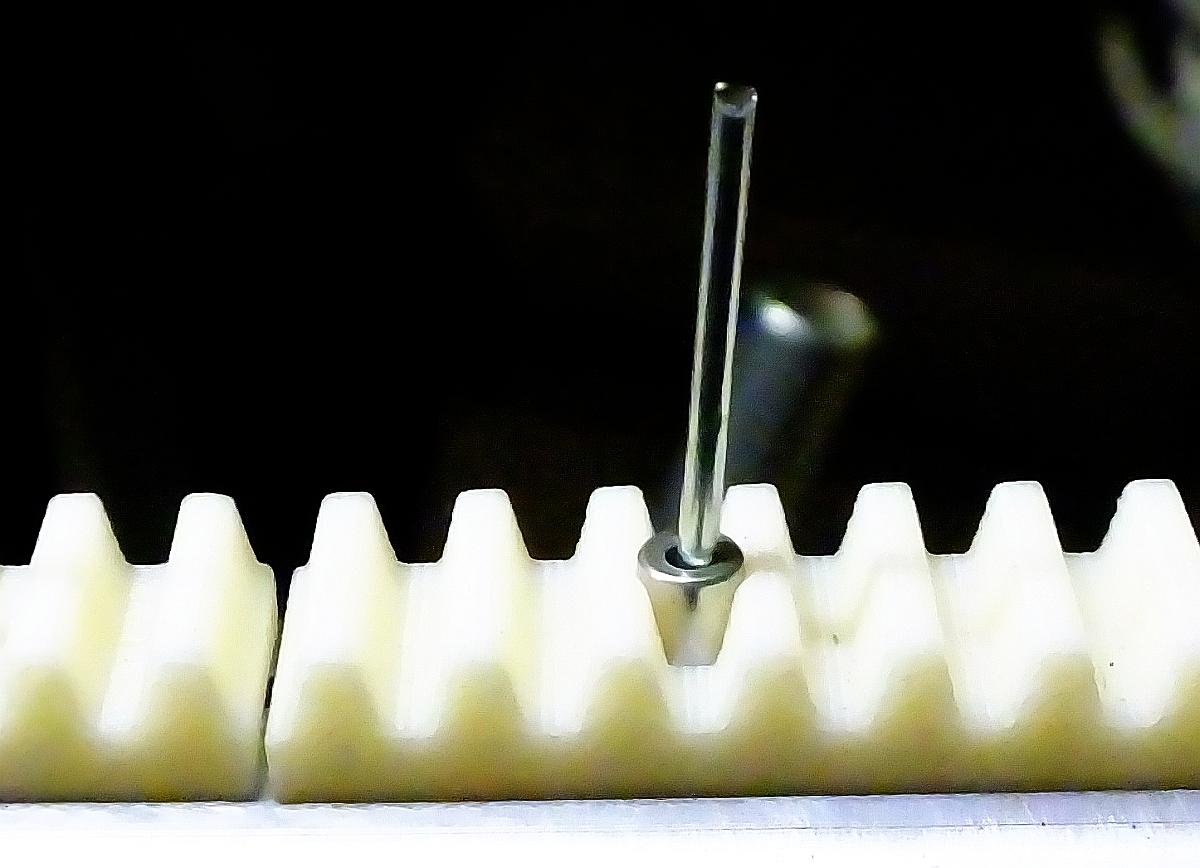

And then the spacer. Again use the 'tamping' tool to bottom the spacer onto the rivet head.
SPACER SET.jpg (504.96 KiB) Viewed 8140 times

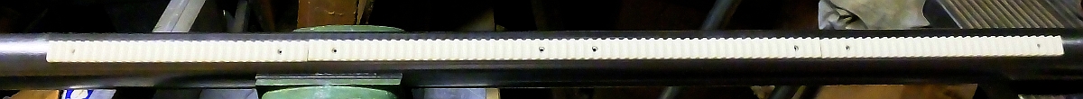

Repeat (again) . . . 3x.

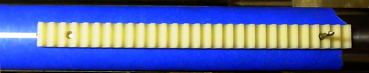

Okay it should now look like this.
Finally compared to 'an original'.
NEW - OLD.jpg (160.7 KiB) Viewed 8140 times
