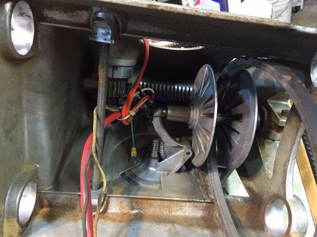

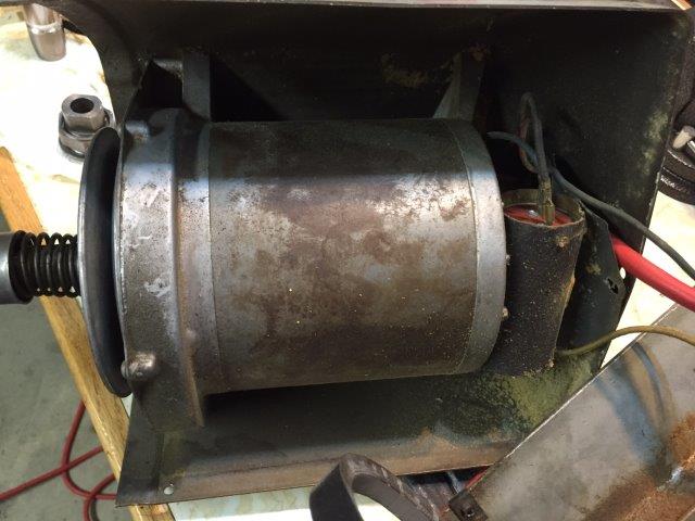

Getting ready to replace the power cord and switch and get rid of the orange extension cord mod that was previously done.
I took a few pictures inside and was wondering if the motor looked original. Any other observations are welcome.
I suspect I have to enlarge the cord hole so the 3 wire and strain relief will fit.

Your motor looks very similar to the one that is in my Greenie so I would say yes but let the experts from the site give you the official nod.
