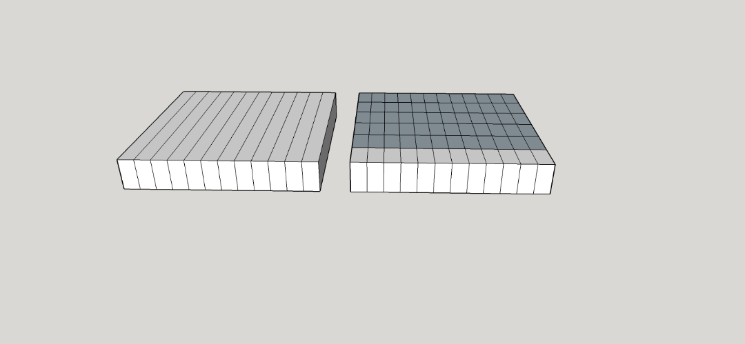

When you get all done, the cutting board will have the same dimensions no matter which of the two ways you make it. Therefore, they would each contain the same amount of wood. However, if using the end grain as the cutting surface, many more cuts will be made and you will lose some wood to the saw dust pile.
2" x 12"x 12" = 2 Board Feet
Which is more difficult? Neither is really difficult but when using the end grain approach, the need for ALL CUTS to be perfectly square and of the same dimension will present some challenge. If you chose this method, spend some time before you start cutting to align your table and fences.
I prefer end grain and I believe an end grain cutting board will last longer in the kitchen.

Ideally it would be the same amount for both, but if using end grain, lets say 1 1/2" lengths, you need to make all those cross cuts which the blade takes out an 1/8 or 3/32 per cut. If using edge grain you dont have all those cuts.
I think and edge grain is easier to do but an end grain holds up better against a knife blade if cut right on the wood.
