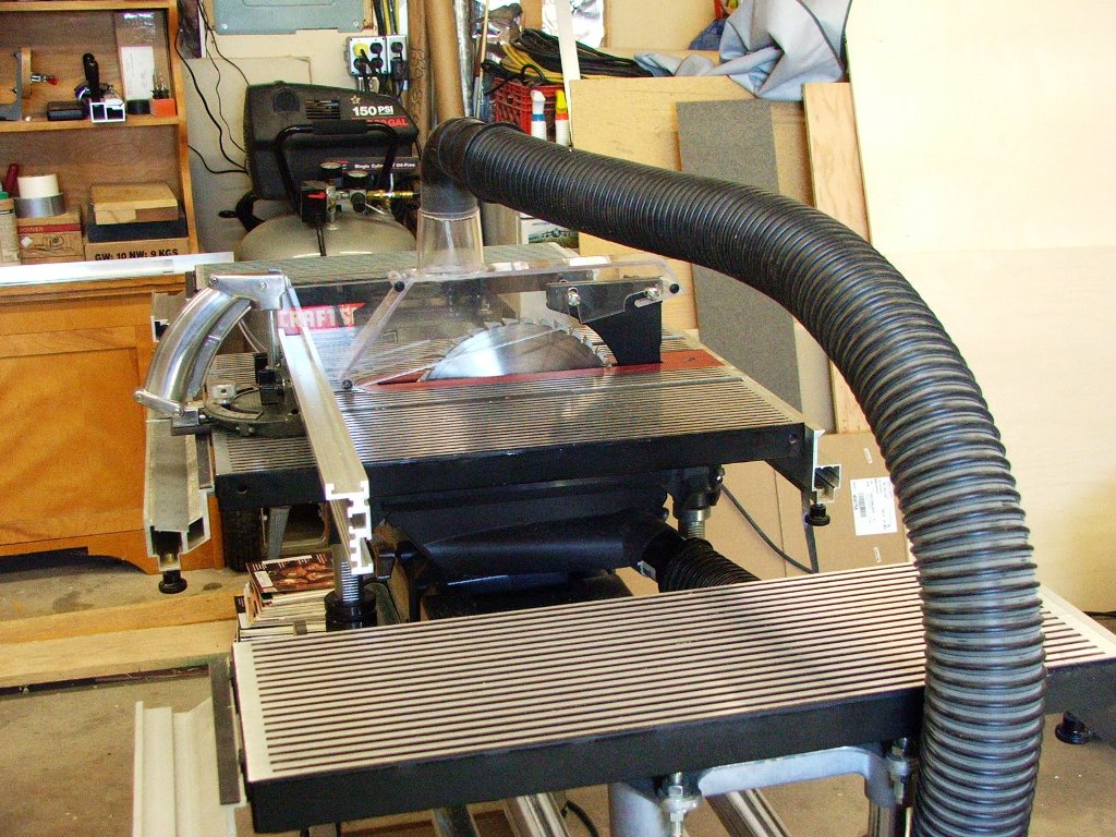

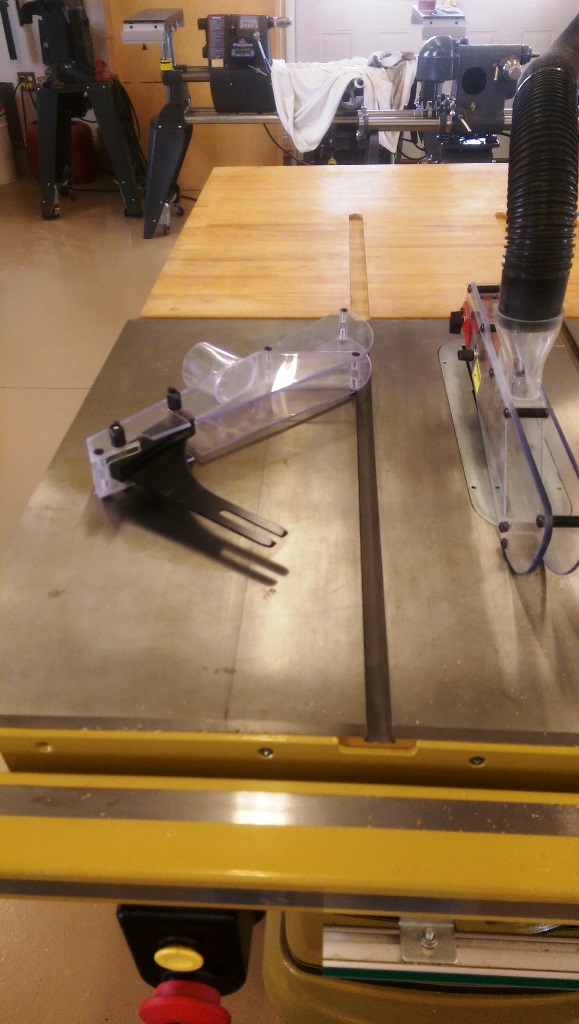

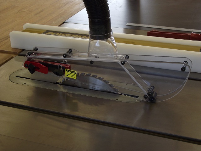

The guard is called the Shark Guard. Here is the link to the SS page.Thleone wrote:John can you send a pic of your upper saw guard hose set up please and any info on the aftermarket parts you mentioned? Thanks to all for your input. The bag was part of the issue but I'm still getting excessive dust out the bottom front. Tape over the adjustable slots has helped a bit but I still feel it's excessive, specially when it piles up on the tool shelf. This is the most frustrating thing on the SS. I'm still in total surprise that SS would one patient such a thing when it is so apparent its not efficient and two not have a fix for our issues. I had to modify the band saw with a second bottom port for the same thing. After all these years they should have it perfected by now if you ask me.
http://www.thesharkguard.com/shopsmith510.php
Yes, they are expensive but they are very well made and the workmanship is first rate and they do make a big difference in dust collection.
My SS one is around 10 years old and is an older design. The one on my PM2000 is the current model and has many improvements. If you buy a SS model today it will be like the one on the Powermatic.
The first picture shows the original SS model when I first got it 10 or so years ago. BTW it was around $100 back then. It is one of the very first ones he made for the SS and I helped him with one of the dimensions of the riving knife that he had slightly wrong.
The second picture shows the current model (SGK1) on my PM2000. The current SS model is like that one.
Again, they are expensive but make a large difference in the amount of dust collected. Also, as far as I know this is the only one available for the SS.
The hose for the SS is two pieces cut to the appropriate length and connected together with a "Y" fitting
- DSCF0407.JPG (225.25 KiB) Viewed 5425 times
- DSCF1292.JPG (138.21 KiB) Viewed 5425 times
- IMAG0278.jpg (175.57 KiB) Viewed 5425 times
