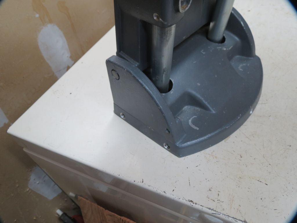

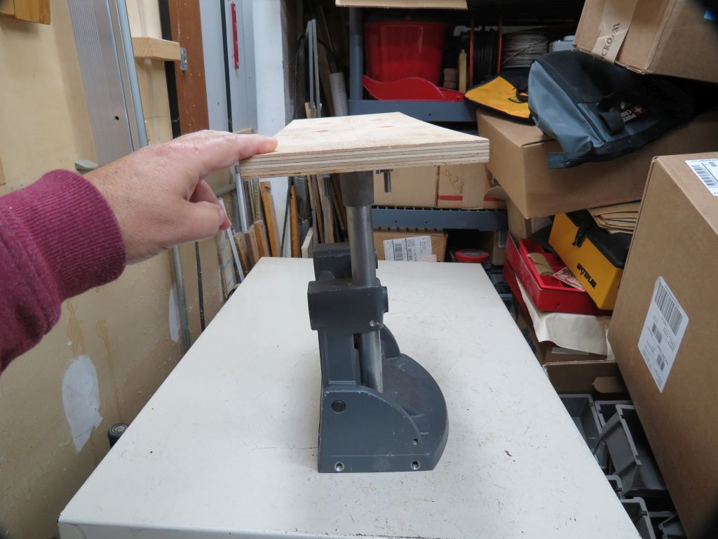

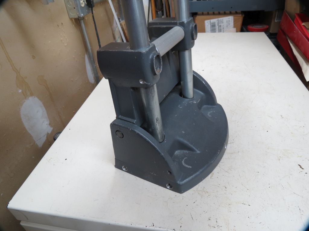

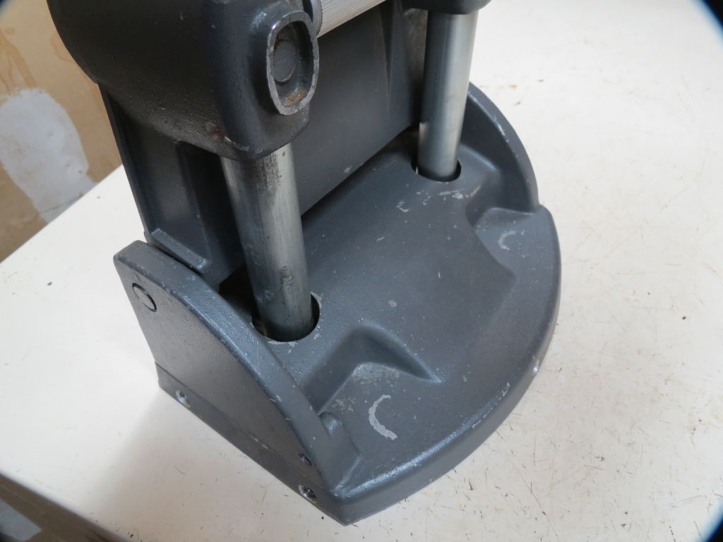

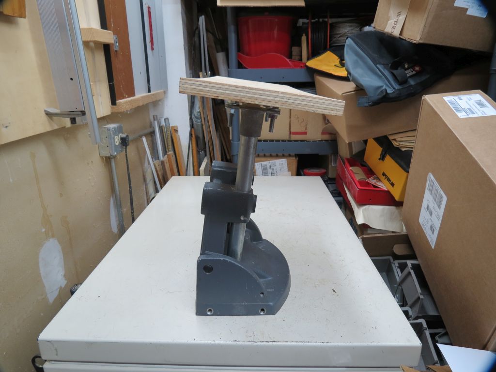

Since I still have my parts from before the upgrade I dug them out to illustrate what we think is happening. No promises but this seems to make the most sense.
I took some pictures so lets look at them. Here the tubes are more or less centered in holes and would be the normal condition.
If the tubes were hitting the back of the holes like this picture
you would expect the end to be leaning as shown here:
This is not the case so lets look at the other condition where the tubes are hitting the tubes like this:
When you then look at it the lean is not so oblivious but enough to cause the parts to not work correctly.
The root cause we think is that the tubes are not fully inserted and the "tipping" is the result of that.
I think the best course of action is to check all the leg bolts to make sure they are tight. For some reason my older machines always need a little tweak each year. If they are loose that can mask the other problem of the tubes be inserted incorrectly.
The next thing to do is to check all the tubes on both ends to make sure they are in as far as they should be. If we are right this will fix the problem. If not then we may have to put our thinking caps back on.

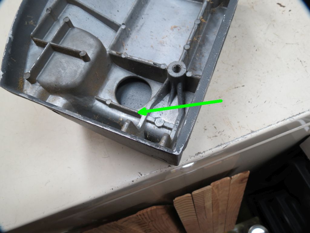

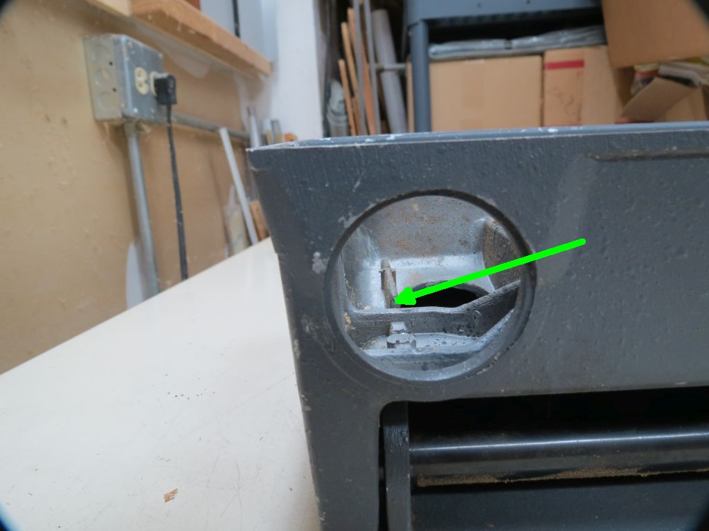

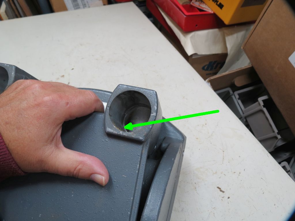

While I have the end out for pictures I took a few of where the tubes go. In this vintage of machine, 1976 this is what it looked like. Other vintages might look different but they all serve the same purpose. You do have a very small amount of wiggle room but I'd say if you are a 1/4" short of inserted all the way you will have problems, even 1/8" is cutting it really close.
Here are a few pictures of the stops involved. The other end is basically the same thing. Also keep in mind the tubes sets are different lengths so if it has been apart by you or a previous owner who knows what might have been altered.
first and second picture are of the same part just another view.
Re: Accessory Table problem
Notice the 2nd and third pix.
http://www.shopsmith.com/ss_forum/viewt ... 342#p41342
If the bench tubes are not seated fully, the hinge end legs will splay(inward) causing the problem.
Ed, you nailed it!

The fourth image (IMG_0148sc.jpg) is the one that shows the problem I have. I'm going into the shop to see what I can do to get the legs centered in the hole. My focus will be on adjusting the bench tubes....I wish I knew what the specs were for installing them. I'm guessing trial and error will reveal the answer!
