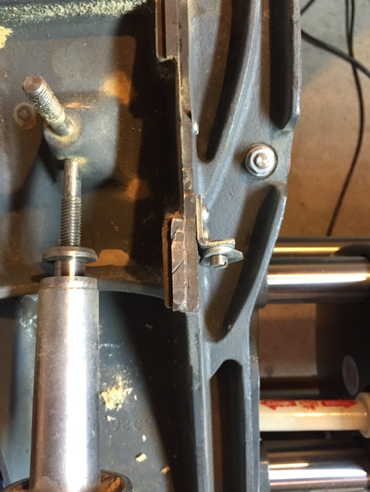

Bruce wrote:I checked my jointer and it would not go past about 3/16. That's enough for my purposes since I've never cut rabbets with my jointer. But I couldn't just leave it in that condition. I disassembled it to check the machined runners for gunk. As the photo shows they weren't gunky, but one of them looks kind of chewed up. A bad casting job perhaps. I ran a flat file along the edges of the raised flats on the right side then waxed the runners and reassembled the jointer. I tightened the nut just until any play was removed from the indeed table. It will now move through the whole range, although it does get a little hard to move past 1/4". Dusty, those stacks of washers are alternating flat and compression washers.

Here is the photo I promised in my earlier post in this thread.
jointer runners
jointer runners

Not really. "Spring washers" are used to keep the proper tension between two mating parts, ie. the sliding ways on the SS jointer. A lock washer (split, star etc.) is used to keep a fastener from coming loose due to vibration or other forces.
