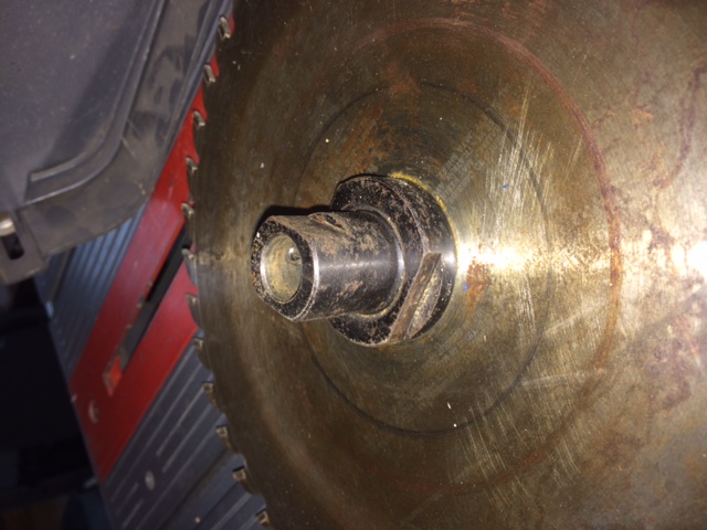

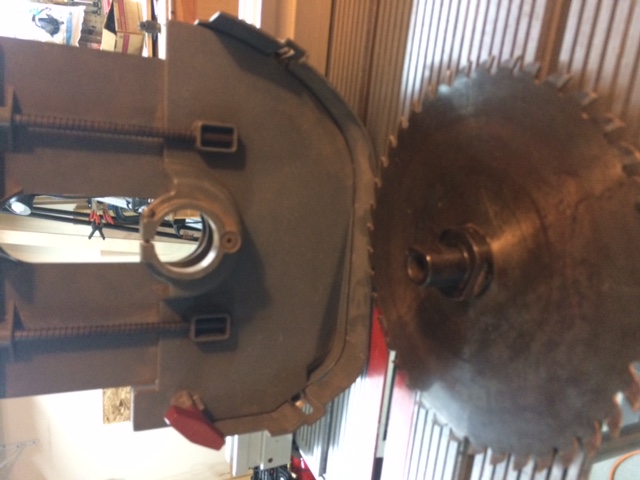

I hope you can see well enough on these. Also, I don't think this should make a difference but I have a blade stabilizer on the Woodworker II.

It is hard to tell from the photos, but are you using a dado arbor instead of a saw blade arbor? When you do this, the end of the arbor with the nut can get hung up on the adjustable part of the lower saw arbor. You also have to pay attention to positioning the table or it will get hung up on the tie bar guard.

Here is a better picture of the arbor with more light. I don't think it is the dado arbor, the owner included a dado blade on an arbor and that one looks different.

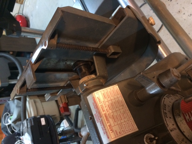

Yes, I can see now it is a 5/8ths saw blade arbor for a 510/520. And you've got the correct lower saw guard. The only adjustment, in out, on the lower saw guard is a screw adjusted with the allen wrench. It is visible in you first pic. I've put a yellow circle around it.
Screw it in, and the blade guard as a whole moves closer to the headstock (and away from the blade). Screw it out and it moves the other direction. Pay attention to the alignment between the blade and the upper saw guard's splitter, which this screw is designed to adjust.

algale wrote: Screw it in, and the blade guard as a whole moves closer to the headstock (and away from the blade). Screw it out and it moves the other direction.
Okay, I screwed it all the way in, but the inner guard is still right up against the blade. Any other ideas?

Not at the moment. By design, the blade sits close to the part of the lower guard that moves up and down on the springs (which I assume you call the inner guard). But when turn you the spindle by hand the blade should clear the guard and not hit it.
