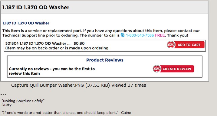

dusty wrote:Strange that you should mention that. I too have been looking at that. In the online drawings of the quill, that part (#63, Shim Washer, 501304) is missing. It also does not exist in the later PowerPro drawings.
I am not sure that this is the root cause of this problem but it seems logical.
Using Adobe Acrobat, I did a search of the new catalog for that part number (501304). It does not exist there.
Question for Malcolm. Does your quill have a rubber washer between the retaining ring and the headstock? The rubber washer on my two machines are about 1/16" thick. Without the rubber washer, my quill would retract that much further which could create your condition.
Note: Spindle Knob is pulled away for clarification (I hope).
I must caution everyone reading this. I believe I have erred on my conclusions. The retaining ring controls how far onto the quill the lower saw guard will go. The rubber gasket is on the opposite side of the retaining ring and in no way effects the lower saw guard position.
The lower saw guard gets pushed up against the outside of the retaining ring.
That was the point I was trying to make that the lower saw guard does get pushed up against the retaining ring but I have found on a couple of Shopsmiths that I purchased owners had put the Quill Bumper Ring on the wrong side of the retaining ring which moves the guard closer to the blade.
