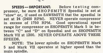

i just purchased an shopsmith air compressor model DM-B i dont have a manual for this. im wondering at what speed i should operate it at. any info on this would be greatly appreciated.

Specs show 1590 RPM. This came out back when the 10ER's were made, so they gave instructions on which pulley sets to use for that speed.
Here's a Guide for the Speed Dial Settings and relative RPM
SLOW 700
A 750
B 850
C 950
D 1050
E 1150
F 1300
G 1450
H 1600
I 1750
J 1900
K 2050
L 2200
M 2400
N 2600
O 2800
P 3000
Q 3250
R 3500
S 3800
T 4100
U 4400
V 4700
W 5100
FAST 5200
I would use H as a top speed setting, yet be aware the Speed Dial Adjustment and Drive Belt condition will have an effect on actual speed.
Good idea to inspect the belt, and adjust the speed dial to insure you are in range.
Also, a safety tip for any Shopsmith is to detach or decouple any accessory or SPT from the headstock before you power it on. Any SPT can run at slow without coming apart. You will find folks here with Bandsaws that didn't fare well coming on in High.
Another reason for readjusting the speed to slow when you turn off the machine as a standard practice.
compressor d-m speed.jpg (60.16 KiB) Viewed 2617 times
Multiply the settings above by 1.6 to get the lower shaft rpms.
I.E. "C" = 1520 rpm.
....."D" = 1680 rpm.
The Sawsmith "2400" assumes a reduction with the pulleys.(2/3?)

You are Correct JPG.
The lower auxiliary spindle turns 1.6 times faster than the other two, or between 1120 RPM and 8320 RPM.
It was a bit confusing as the manual showed Mark 5 with it driven from Lower Auxiliary shaft, and Mark 2 from the upper Auxiliary Shaft (Quill Speed) I have some photos of that somewhere that I will dig up and post later
Here's a Guide for the Speed Dial Settings and relative RPM for Quill and Auxillary Shafts
Quill Lower Aux
SLOW 700 1120
A 750 1200
B 850 1360
C 950 1520
D 1050 1680
E 1150 1840
F 1300 2080
G 1450 2320
H 1600 2560
I 1750 2800
J 1900 3040
K 2050 3280
L 2200 3520
M 2400 3840
N 2600 4160
O 2800 4480
P 3000 4800
Q 3250 5200
R 3500 5600
S 3800 6080
T 4100 6560
U 4400 7040
V 4700 7520
W 5100 8160
FAST 5200 8320
Everett

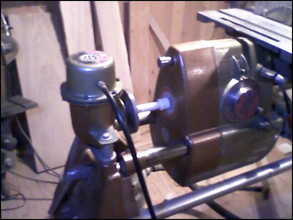

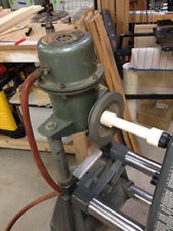

top mounted.jpg (46.46 KiB) Viewed 2528 times
aux shaft mounted.jpg (25.73 KiB) Viewed 2528 times
And the original was indeed a rubber diaphragm.
Link to thread from which photo came http://www.shopsmith.com/ss_forum/viewt ... 35#p123435
Everett
