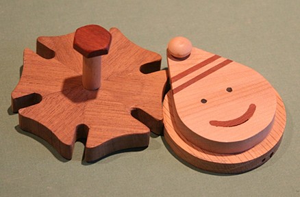

Ok Dave, here are two more pictures and a description of a couple components.
The wheel with the six slots mates with the clown and the two rounded surfaces slide past each other. But underneath the clown's hat (below the little ball) is a 1/4 inch dowel that slips into one of the slots as the clown rotates and carries the gear with it. When the dowel slips out, the gear stops until the dowel comes around to the next slot. Hence intermittent rotation.

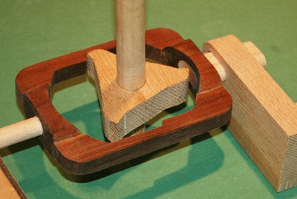

The strange looking yoke and triangular 'gear' are sort of hidden inside. They are designed to provide lateral movement back and forth. As the gear rotates, the top corner pawl catches the yoke and moves it to the left. When the pawl slips out, the yoke stops momentarily until the bottom pawl shoves it to the right.
machine 51.jpg (39.23 KiB) Viewed 3733 times
I did not want the yoke to rotate, so I made the right 'shaft' flat.
I hope that all makes sense.

You're inspiring me to build a clock. A couple of years ago I built a gear-driven yarn winder designed by this guy. http://www.lisaboyer.com/Claytonsite/Claytonsite1.htm
But, after looking at your mechanism, I started looking at clocks designed by this guy http://www.woodenclocks.co.uk/mechanism ... jects.html. Looking around his stuff, it looks like your clown picture #50 is an example of a Geneva mechanism. I'm guessing that's what drives the date-change mechanism on a mechanical watch.

Wait a minute. Did you do what I think you did?
I'm looking at the clown picture. It appears that the gear the clown drives is made from 6 separate triangles all mitered together, rather than simply being cut from a single piece of wood. Am I right?

davebodner wrote:Wait a minute. Did you do what I think you did?
Yes, it is. And don't ask me why. Although for the sprockets, for example, I found it better to cut the teeth with the grain sticking outwards. It is less likely to break.
I used mahogany for that piece, but several other wood species for the others. I have a piece of ebony but never worked with it yet.
