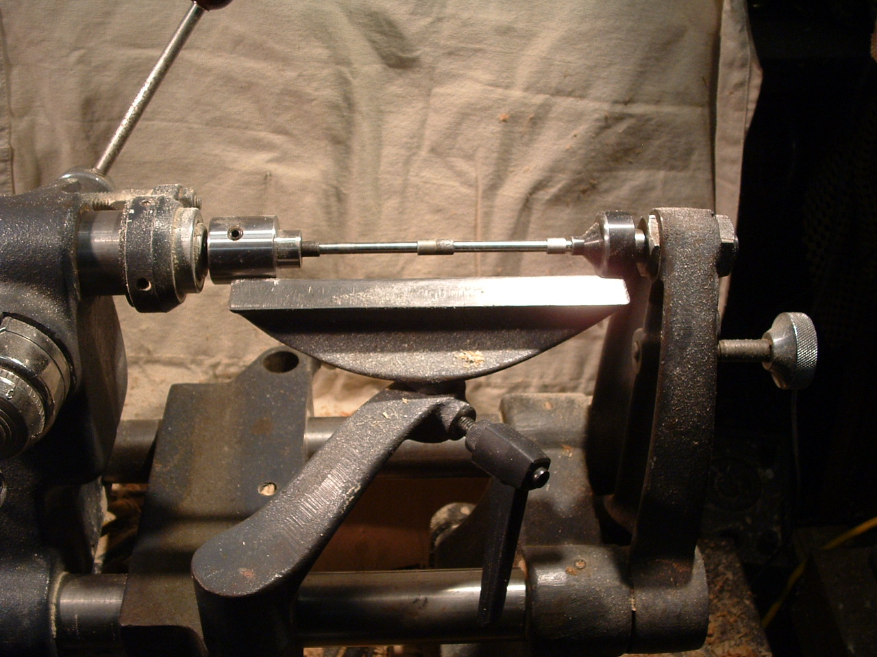

I will take another crack at it.
Because the set up for pens is so short you need to position the carriage to the left, close to the headstock, and angle the arm to the right, to get rest in the proper position.
Here is a picture of the setup on my 10er. I didn't have a drilled blank to mount but you'll get the idea.
Let us know if any of the suggestions have helped. If not, more information would help to zero in on the answer.
What model SS do you have? Do you have the Universal Lathe Tool Rest or the stock tool rest?
A picture showing the problem would also be helpful. :cool:
