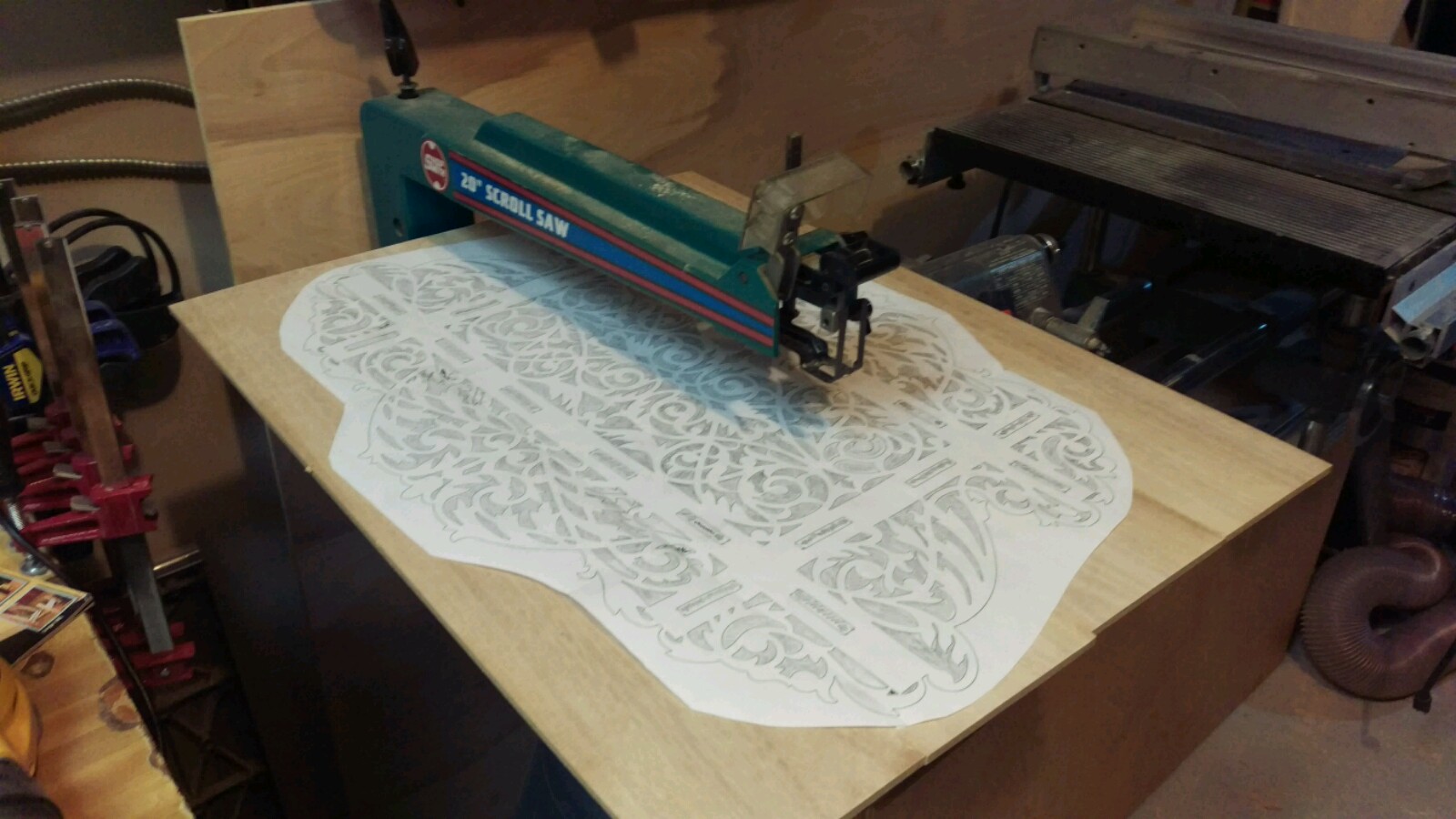

Beave2012 wrote:Largest in the industry or not, the pattern is 18x28. My project is just to big. Lol.
I've never done painters tape on both sides. Should help with tearout I assume?
I think I'll be spending an hour or more just at the drill press after that.
Yes, with the painters tape and a reverse tooth blade there is almost no tear out.
Probably should get a stool over to the drill press. :)

First, cut ALL the excess wood off the blank yp to about 1/2" of the outside of the pattern.
The SS scroll saw has a 20" throat, the longest and the biggest table in the industry. As long as your work piece is less than 40" long (38" would be better) you just have to cut one half of the pattern and then turn the stock around and cut the other half.

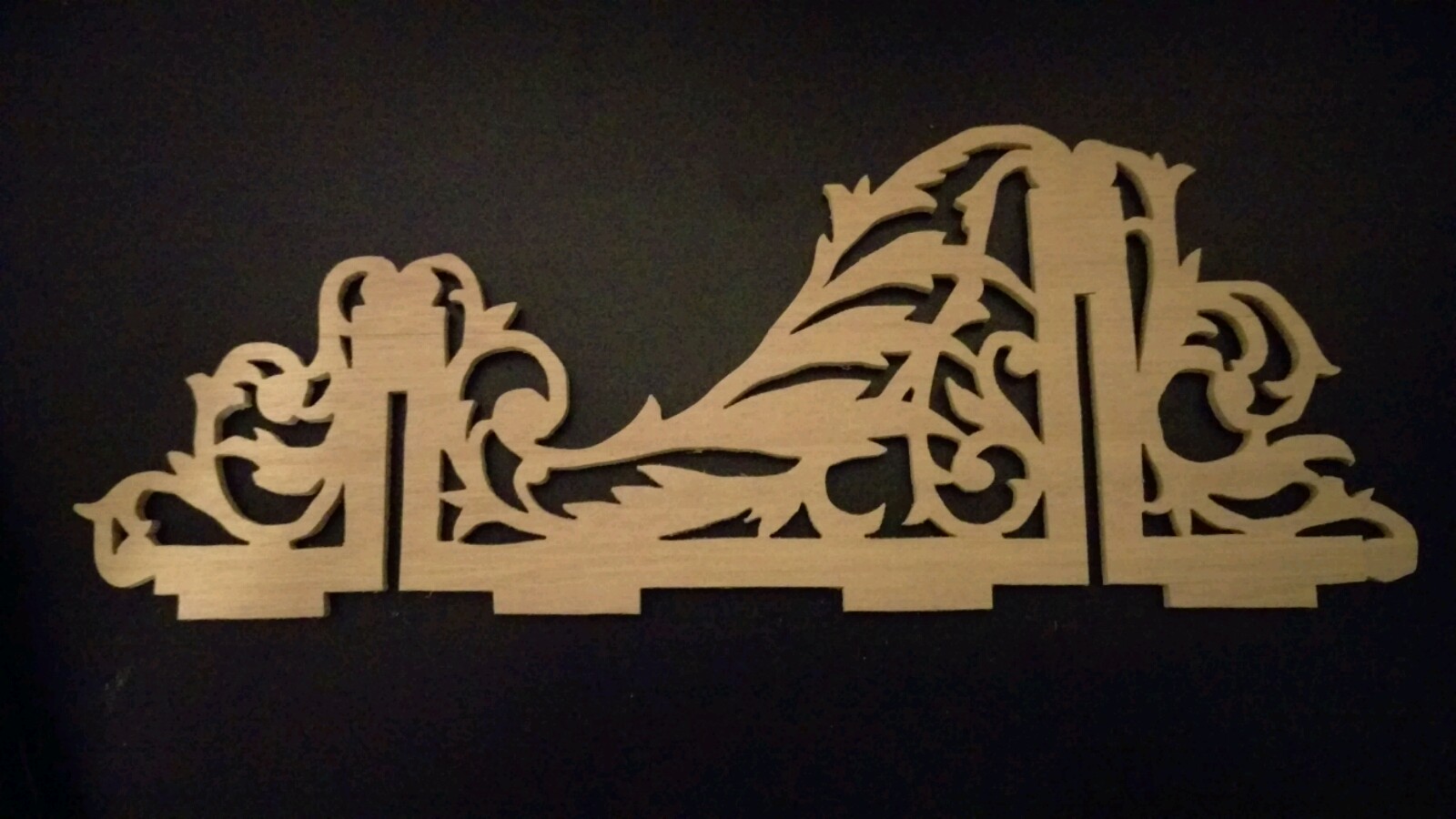

Started the project cutting. Haven't gotten to the large piece yet, but the two sides are done, minus sanding the burrs off.

That looks really good! I've ordered some of the magical "Flying Dutchman" scroll saw blades that many on the Forum swear by and I'm going to try to make friends with my scroll saw.
Re: Scroll sawing into insanity
That really looks good!!!!
Whatever blade you are using did not cause you to 'goof'!
Keep your patience working.
P.S. It may be easier to position the large piece rotated 90 and use the main table and floater for support to the right side.

I used a standard skip tooth blade for that. I always run on "a" speed for fret work. I actually tried to listen to head phones this time, hated it. Needed to hear the blade cutting to stay accurate.
I will use the table extension for extra support, thanks for the advise.
