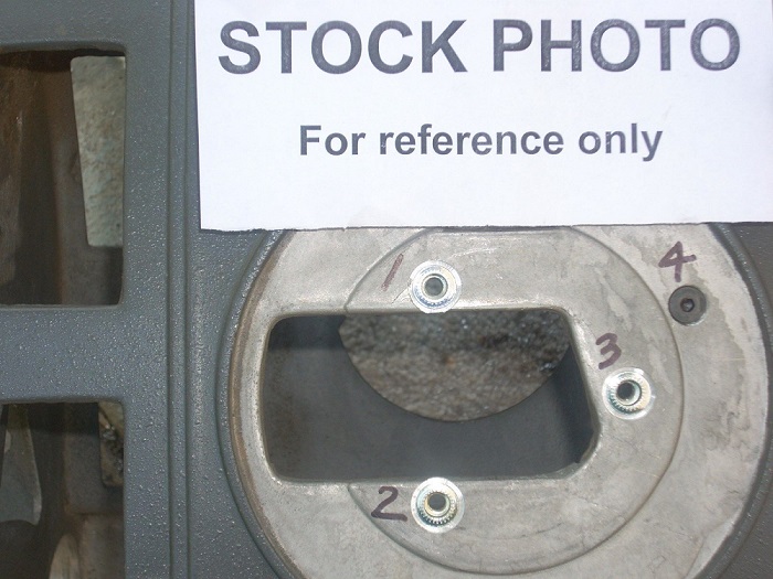

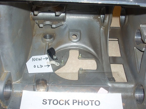

A seller on Ebay (simon*e) uses steel nut inserts in the casting where the speed assembly attaches. He has some nice pictures of this "improved and upgraded headstock". In addition to this improvement he install A full round cable holder using a secured countersink screw and lock nut.
- Here are the inserts he adds
- steel nut inserts.jpg (119.4 KiB) Viewed 1530 times
- new wire clip
- steel insert with new wire clip simon eng.jpg (68.08 KiB) Viewed 1530 times
