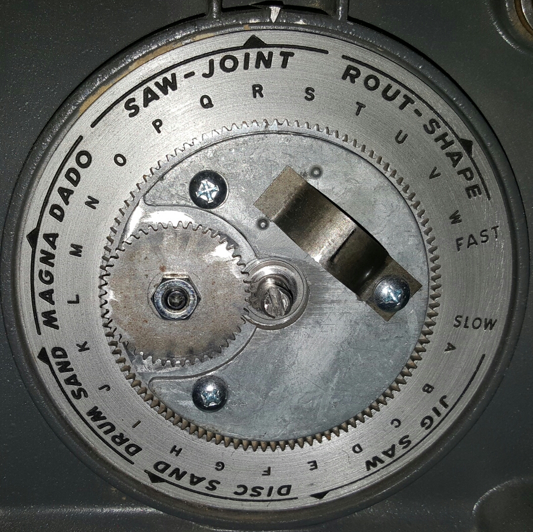

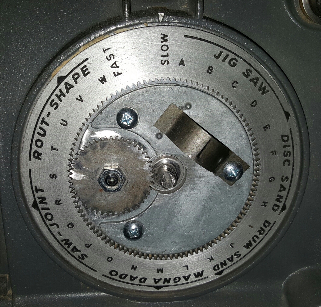

With the "ShopSmith" knob off, and the outer speed dial freely turning, it's limits are indicated in the pictures. From "Slow" to "R". I'm pretty sure what sets this limit of the speed dial outer ring is the groove on the back, and the solid section doesn't allow it to pass around. So I'm confused why this is. Or, if I'm wrong, then why is it stopping there? And why can't my outer ring go all the way to "Rout-Shape" or "Fast"?

Fear not! That is 'normal'.
Look at the back side of the 'ring'. There is a groove that 'stops' at about the point in your pix. There is a slight ramp out of the groove.
Now look at the headstock. There should be a small weird spring that 'sticks out' from the headstock.
That spring rides in the groove until the ramp hits it. Further rotation of the ring will cause the spring to ride up onto the ramp. This creates back force against the ring.
Push harder! The ring will then advance towards fast.
When being rotated by the control knob(by way of the idler gear) this back force is barely perceptible.
The original design(A headstock) had a depressible stop instead of the spring. The stop spring was located just below the power switch and had a button that rode in the groove.

Man I love this forum!
Thanks for the quick and informative reply. Being my first experience with a ShopSmith, I really don't want to mess it up.
So in one direction, that screw keeps the control arm from going too far, and thereby keeps the dial from continuing to turn. What keeps the dial from going too far in the opposite direction? Is it the tension of the belt keeping the sheaves from moving closer and thus preventing the arm from moving and the dial from turning?
Sorry, don't know how else to phrase that...
Re: Outer speed dial stops at "saw-joint"
lilgodwin wrote:Man I love this forum!
If you are referring to the high speed stop screw, then yes.
In the opposite direction(slow) the control sheave bottoms out against the idler sheave. The sheaves bottom out before the belt exits the pulley.
Realize the floating sheave on the motor pulley gets in the act. It reacts to belt tension changed by the control sheave etc..
The dial is merely an indicator and moves with the control knob only. It has no 'control'. Normally the control sheave moves with the control knob(by way of the porkchop aka quadrant gear) and that results in speed changes.
