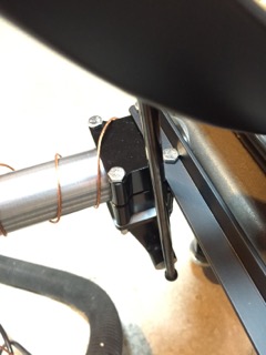

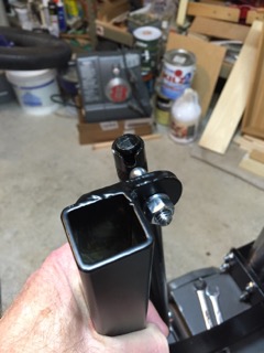

I'm installing my PowerPro lift assist today and ran into a little snag in the adjustment procedure. As many know, the cylinder comes fully extended. With the lower assembly pushed left as far as it can go without interfering with the cylinder rod, it is still to long to snap onto the ball. Do I somehow compress the cylinder a little to get it to pop onto the ball? If so, how hard is it to compress and will it just pop back out? See pics.

Never mind. The instructions were backwards, or at least my understanding of them was. All is good now.
