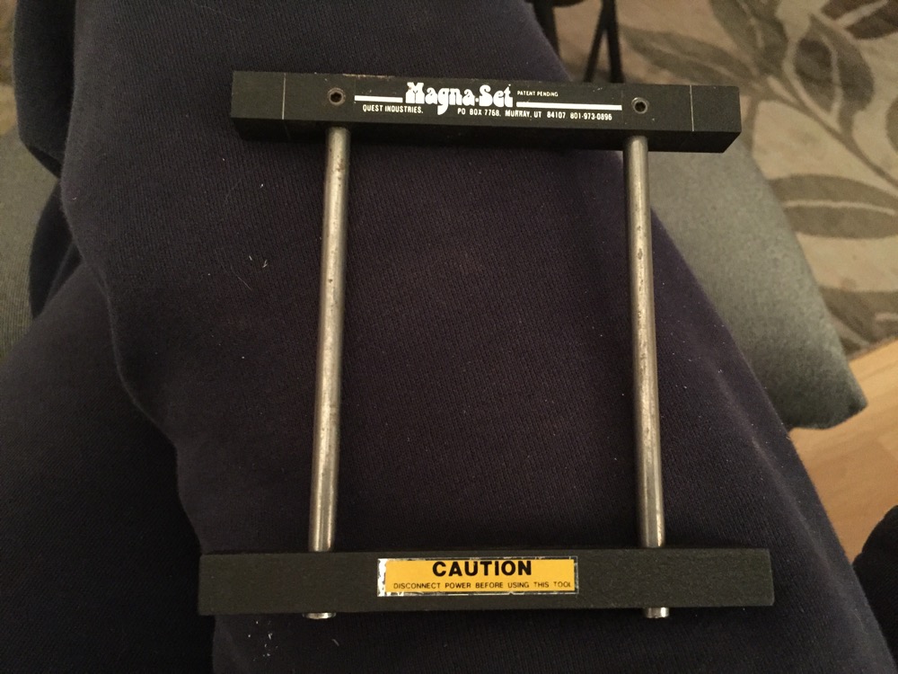

Here's what I use fwiw. They both work great. The Magna set is for the jointer and the planer pal for the planer.
Paul
