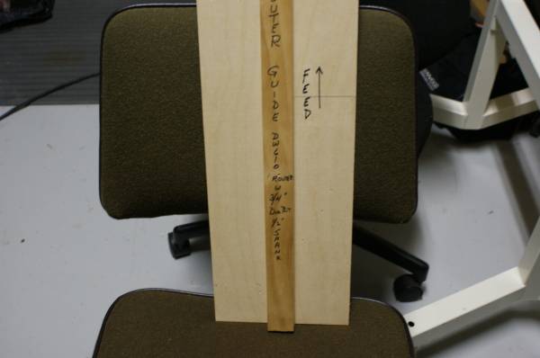

A skill saw or a router guide can be made in a few minutes using some shop scraps. It can be made in virtually any length required.
I made this one for cutting dadoes for shelves for a console for my wife's sewing room.
router guide 2.jpg (71.81 KiB) Viewed 3503 times
After attaching the cleat to the board use the router or skill saw to cut the right hand edge. To use, place the right hand edge of the board right on the line you want to cut and put the base plate of the tool against the cleat and make the cut.
If you want to keep the jig mark it for the tool it was made for and the saw blade or router bit used to make it. Also make the left side of the jig wide so there is enough room for clamps.
Fast, efficient and cheap!!! Like me.
