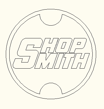

How did you make the ShopSmith Logo? Do you have a template / drawing? Was it a sticker? I'm looking to add such a logo on my accessory cart.
Also, what paint did you use? Any recommendations on prep work, number of coats, etc? Thanks

Thanks for posting the painting pictures. It looks great.
I'm going to use your process to paint my accessory cart. I made a CAD drawing of the logo to make the cutting easier. Hope it can help others as well. If anyone wants the file, sent me a PM.
