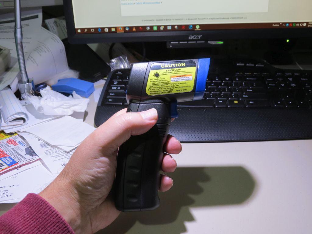

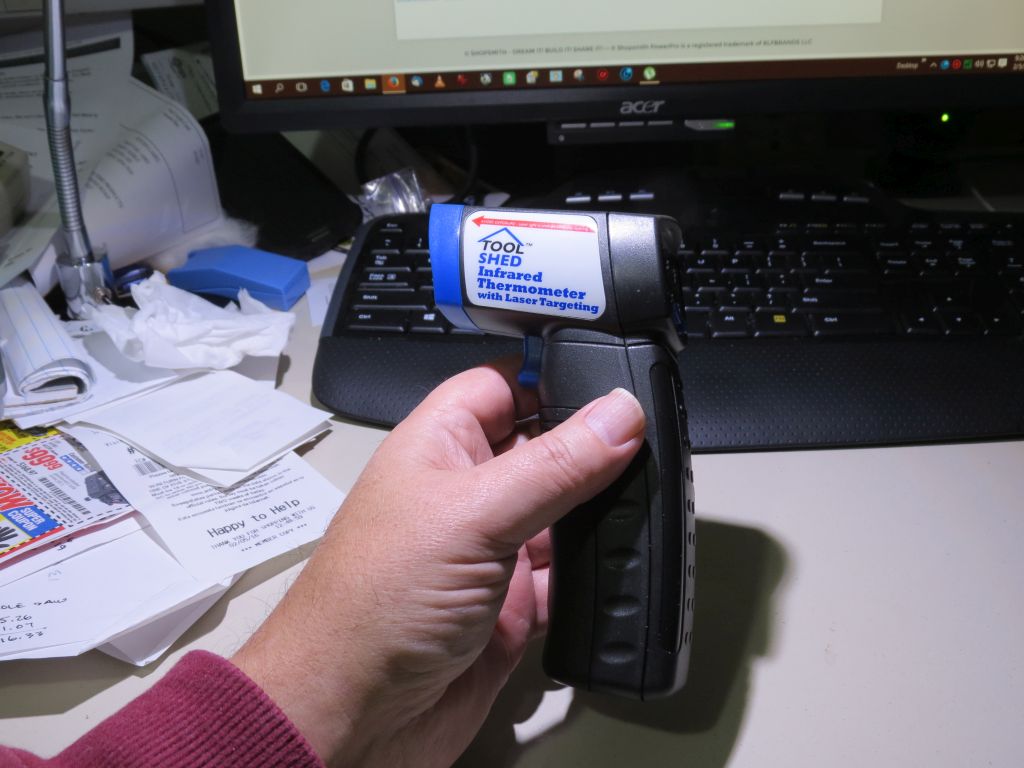

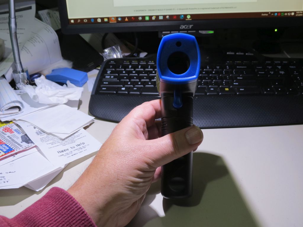

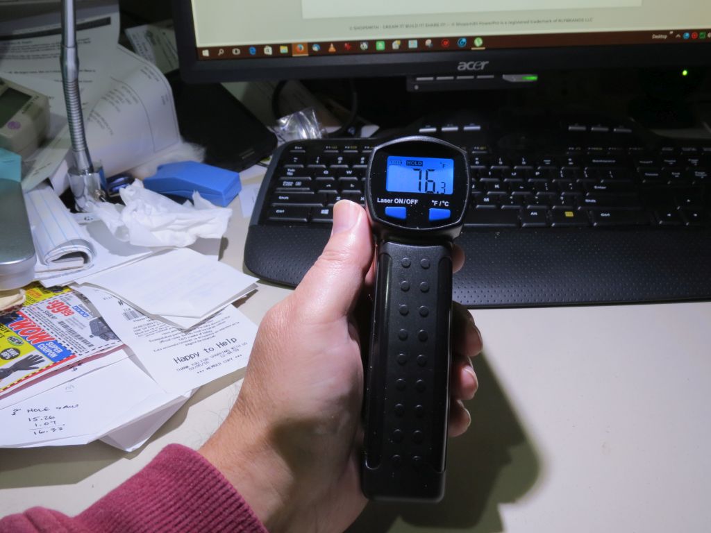

The laser is optional on this item. It can be turned on or left off, it is only used to give you an idea of where it is pointed. At 12" away the spot where it is working is a 1" diameter. At 24" the spot is 2", like wise at 36" the spot is 3". You can do the rest of the figuring if you want but that is how this one works.
So what is it?
It has a nonslip grip.
Uses a 9V battery, and has low battery indicator.
It turns itself off after 20 seconds.
Response time is about 1 second.
Above freezing it is accurate with in +/- 2% or +/- 3.6 degrees F.
Below freezing it is accurate with in +/- 3% or +/- 5.4 degrees F.
The display will read either Celsius or Fahrenheit with back lighting.
It has last temperature recall.
Now you can pretty much guess that I have an Infrared Thermometer with laser targeting.
I've wanted one of these for year. I just didn't want to spend the amount they wanted for one. In the last couple of years the prices have dropped with more cheap models flooding the market. Most that I looked at the Distance to spot size was in the at 8" the spot was 1". I was looking for one with at least a 12" spot of 1". This one does that.
Just a couple of years ago you could spend $50 for one of these, I actually had one in my cart and then thought do I really need to spend this on this tool... I put it back. Then I saw them at $30, again I was almost ready to buy but held back. Then I saw them for $15, that is more to my liking but I still held back.
Out at the Rural King I came upon one for an after rebate price of $8.79. My wait is over.
So now when I feel like measuring the temperature of my shopsmith I can tell just how hot or cold it is. Want to check if I'm still alive, open mouth and measure. BTW it says about 96 degrees so I think I'm safely say I'm still kicking.
