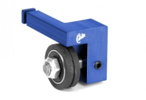

First, the difference between a 5/8" blade and a 1/2" blade is negligible in my opinion. I have a wood slicer and a Timber Wolf 1/2" re-saw blade. The Timber Wolf is every bit as good as the highly hyped wood slicer at half the price.
Cool blocks for re-sawing? I don't think so. At 6" the blade will want to wander. If the wood wants the blade to twist what is going to stop it with cool blocks? The blade will twist and cut into the cool blocks since they are soft. With the steel guides all you get is friction and heat build up that can ruin the blade. Carter roller guides are the only way to go in my opinion.
As far as bringing the guide blocks up to the bottom of the gullets, I don't know. I have had Carter roller guide on my band saw since they first came out. I wouldn't think a 1/16"+- would make any real difference.
Does anyone out there know of a 12" or over band saw that does not have roller guides? OOps, maybe Harbor Freight. :eek: :eek:

jsburger wrote: Cool blocks for re-sawing? I don't think so. At 6" the blade will want to wander. If the wood wants the blade to twist what is going to stop it with cool blocks? The blade will twist and cut into the cool blocks since they are soft. With the steel guides all you get is friction and heat build up that can ruin the blade. Carter roller guides are the only way to go in my opinion.
Got a disagreement here, John. I have successfully used cool blocks for tight curves (using a 1/16" blade) and also straight re-saw jobs.
Although the cool blocks must be re-surfaced to a squared contact surface, they will stay square when running along the sides of any larger blade. Oh yeah!, if there is a raised weld on any wider blade, it must be smoothed to avoid any "clunking" as the weld passes the blocks.
The best thing about cool blocks is their ability to lubricate the saw blade.
Once again, if the cool blocks are squared properly, there is no issue for their use with wider blades.
Posts: 6585
Re: Band Saw Frustration And Seeking Blade Recommendati
As I remember (could be wrong as I often am) one of the things touted about cool blocks is you can bury the teeth in the blocks which gives added support to the business side of the blade. The only problem is the teeth cut into the blocks so the support diminishes. As you said, the ends can be dressed but who wants to do that every few times the band saw is used?
I certainly think with a 1/16" blade totally buried in the cool blocks they will allow the blade to twist to follow tight curves since the teeth cut into the blocks. The twist is good with a 1/16" blade following tight curves. Carter makes a guide to replace the SS upper guides to allow tight curves with narrow blades. It allows the blade to twist to follow tight curves.
For re-sawing, yes if you don't bury the teeth in the blocks they will not ware much. Lube from the blocks is a plus if it really occurs. Maybe just less friction, don't know.
Roller guides don't require "lube" so that is a wash.
I don't really disagree with your observations. I guess I would categorize cool blocks as a cheap alternative to roller guides. Nothing really wrong with that if it work for you. :)
