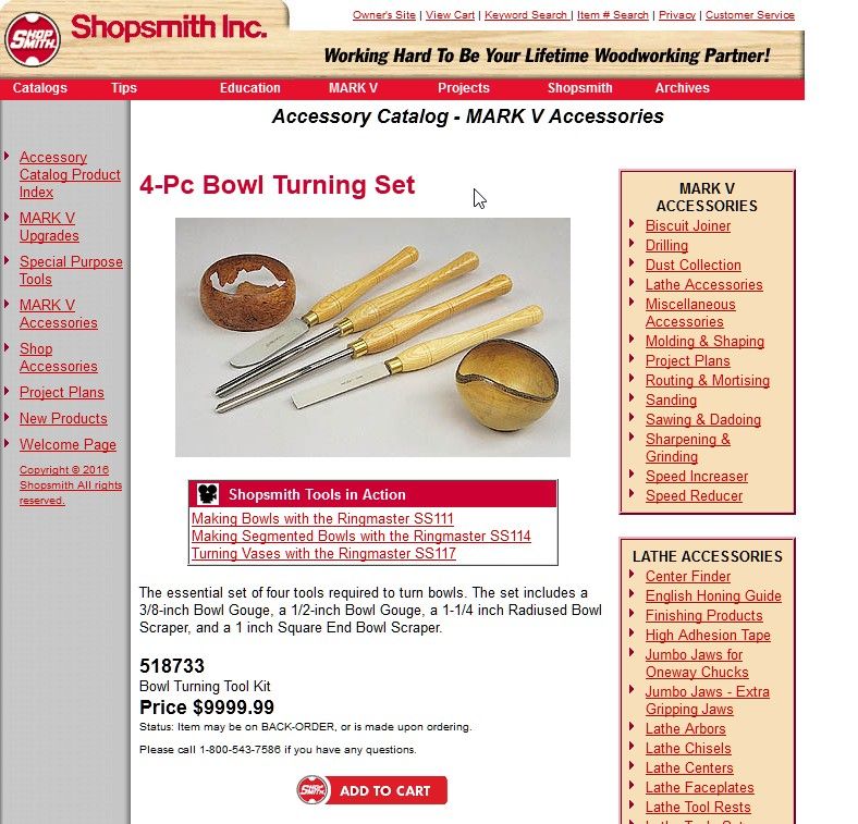

There have been some discussions about these of late so I figured I'd do a posting so we can find some other details out about them, well that is if anyone wants to share.
I got a set some years back and I still have to get in to bowl turning. Mine reside on a shelf still in the box they came in. I don't recall the price and well I don't think you can get them anymore from shopsmith.
I was able to find a page with them at the site but.....
ScreenHunter_96 Feb. 14 15.07.jpg (125.88 KiB) Viewed 4531 times
Now if anyone wants my set for $9999.99 I will throw in free shipping, first come and all that sort of stuff.
Yea I thought not.
So the finish on these is nothing like the normal spindle tools they sell. Very nicely done. The handles have a very different shape as well. Perhaps someone can guess who made these for shopsmith?? I think if one looks at the catalog images some brand seems likely.
The bowl gouges come in at about 23" long, the other tool are shorter but then that is the nature of the use of these.
They are labeled HSS, from all accounts M2 steel (based on the results of test done on a set of these AAW 2008).
I know some of you own these and they have been discussions it the past. I'd like to here so current information on this set and how you use it.

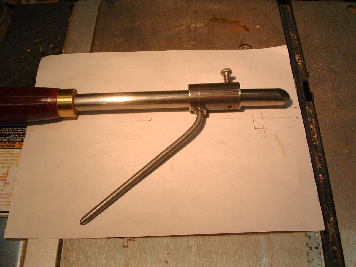

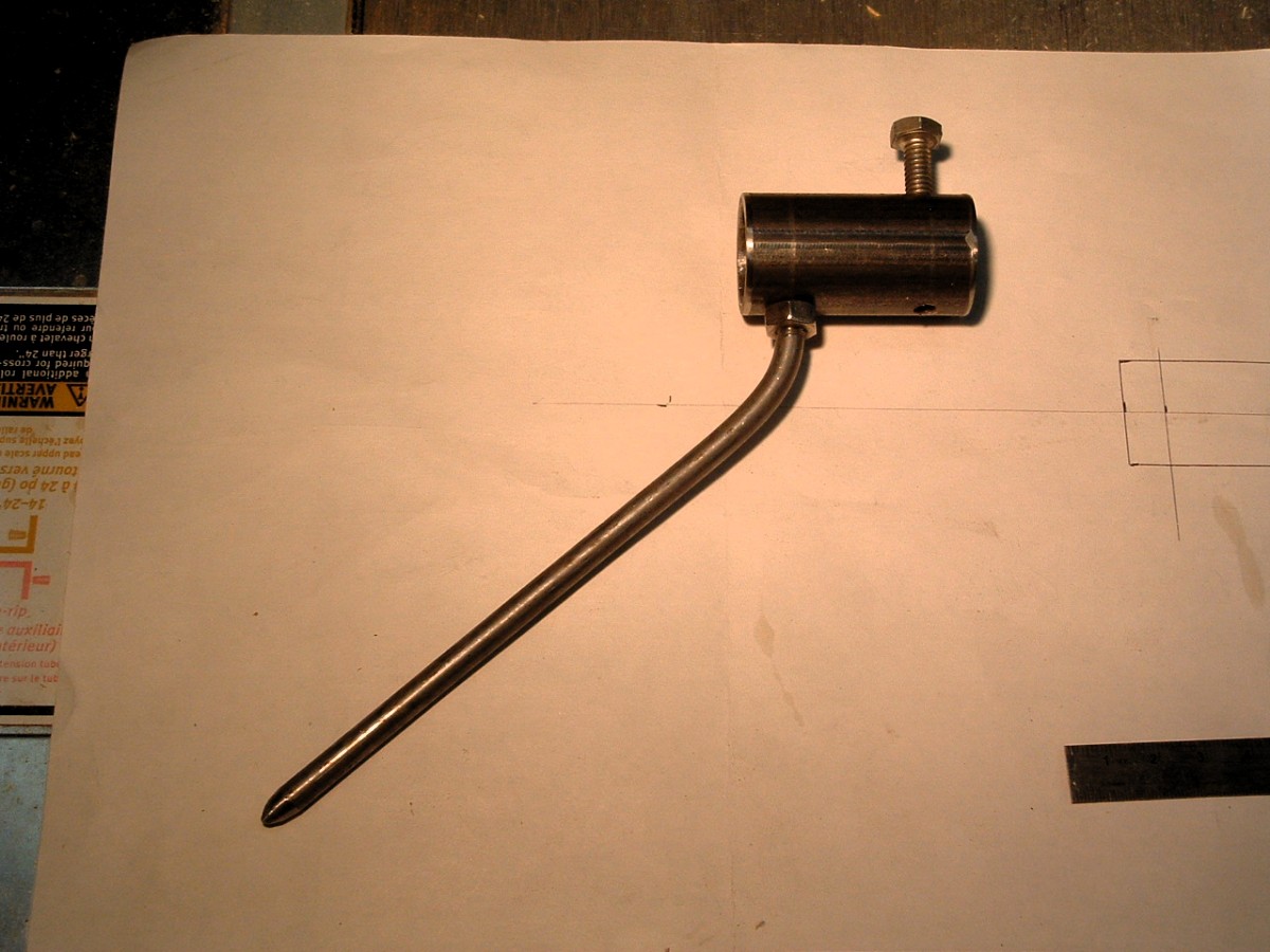

For those of us on limited tool budgets, Cap'n Eddie has a video and plans to make a jig for the Ellsworth grind.
[youtube]https://www.youtube.com/watch?v=5i9RDnJHz9g[/youtube]
I made one last fall. I used a 3/4" iron pipe nipple.
I've only used it a couple of times but it has worked well so far. :D

Pretty much identical to what Ellsworth sells.
