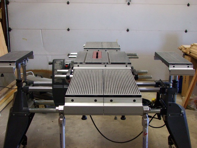

Posts: 6585
Re: Table saw enlargement?
Gino wrote:id like to increase the size of the table and have it be more functional . It seems to me that it is very difficult to dado long material. Shelves and cabinets ...
Frankly it just feels awkward and even risky with the simple table as is. Space is limmited and I'd like to put this machine to work and buy something expensive. I suppose I'll do this type of dado work with a router and buy attachment so as to feel more comfortable. Great suggestions and help, thanks
This will work and can be tilted. However, it is not real cheap. Watch eBay for the extra floating tables and tubes at a good price.
DSCF0453 (640x480).jpg (92.23 KiB) Viewed 3629 times
This works very well BUT we don't know which model Shopsmith Gino has as a base. He is attempting to eliminate issues caused by a "small table surface". This makes me ASSUME he has a 500. This solution would then not be ideal.
