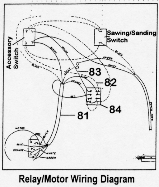

Only wiring diagram I could find easily:
[ATTACH]1903[/ATTACH]
Craftsman Station Wirrings.gif (168.57 KiB) Viewed 13001 times

Thank you very much, Nick.
This does the job. The only thing it lacks is information on the relay and I have gotten that from the component manufacturer (NTE Electronics).
This will allow me to confirm that I have built the wiring harness correctly. Now I may have the nerve to connect my new motor to the harness.
Up until now, I have had the motor installed but it is not reversible. That is to say, I have installed it to support the saw mode only (CCW rotation of the motor).
Thanks again. I especially appreciate your effort, knowing how very busy you are.
