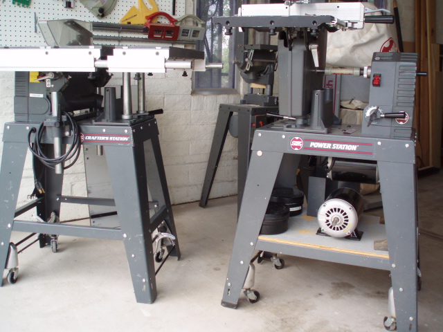

- P7270001.JPG (157.04 KiB) Viewed 48848 times
- P7270002.JPG (161.92 KiB) Viewed 48818 times
- P7270003.JPG (153.57 KiB) Viewed 48810 times
- P7270006.JPG (144.86 KiB) Viewed 48815 times

Hi dusty,
Thanks for the pictures. I went back to your earlier link to the SS FAQ page describing the Crafters Station. It says that it is a bandsaw, along with a table saw and a "snading system" (spelling error belongs to SS). How does the bandsaw work? Or do you use the std SS bandsaw SPT on it?
Do you plan on using it for a sanding station? I think that is what I wood do with it. Then I could avoid frequent changing of the Mark V. Have fun!
edit: For use as a sanding station, do you use SS SPT's or is the Crafters Station "self contained"? I realize that the drill press and lathe modes are not available on it, but if the SPT's ARE used on it, and you can use it as a "Complete Sanding System", I find it odd that there is no mention of using the jointer or planer on it. Can you shed any light?

Tim;
I too noticed that the description does not mention the other SPT. The CS Manual, however, contains procedures for installation and alignment of the Strip Sander, Scroll Saw and Jointer - in addition to the Belt Sander and Band Saw.
I received an additional sanding disk (with velcro), lower saw guard, combination blade, 1/2" chuck & key, caster set and a saw guard that is not for the Shopsmith.
The band saw is a slightly newer unit than the one I have. This one has a dust collection port and it is actually quieter than my own even though it has the old style guide bearings and cool blocks. It was way out of alignment - everything that is adjustable.
You ask how I intend to use it. I really don't know for sure. When I decided to buy it, I saw it as a 2nd power station. Now that it is in the shop, I see it more as a table saw. It is normally equipped with a 3/4 horse motor. When I get the doctors report on the motor, if it can't be repaired - I'm thinking about putting a 1 horse or 1 1/4 horse on it.
Depth of cut is limited and it has no quill. No quill - can you imagine that. I've become so used to a quill.
I moved my jointer off the Power Station and mounted it on the Mark V today. I have my band saw on the original Power Station.
Actually, what has happened is I have abandoned my original reason for having a Shopsmith Mark V which was that I didn't have room for all of the various stand alones. Now that is almost what I have.
