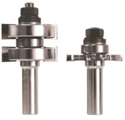

This is the Freud T&G bit set that I bought for my paneling project. I measured the max depth of cut at 7/16" for both the tongue and the groove, which is what you get if you guide on the bearings. But I'll be running the lumber against the fence of a router table, and so I can cut to whatever depth I want.
T&G bits.JPG (21.3 KiB) Viewed 2395 times

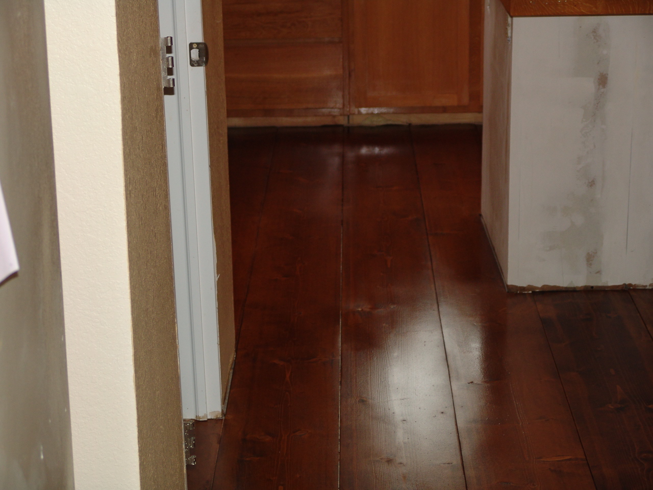

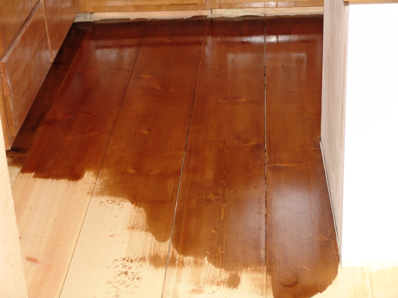

Here are some more pictures. Floor was edge sanded this morning using my Porter Cable Random Orbit Sander (ROS) with 80 grit paper. Then the rest was double sanded using a rented commercial 4 disc ROS two times with 60 grit and two times using 80 grit. Then swept vacuumed and coated with MinWax Wood Conditioner. Last but not least was a coat of MinWax Oil Stain Early American #230. Now I am going to give it till 10PM tonight to dry and then I will start the first of 3 coats of MinWax Poly Floor Finisher Semi Gloss.
floor finishing 002.JPG (547.68 KiB) Viewed 2377 times
floor finishing 004.JPG (526.97 KiB) Viewed 2377 times

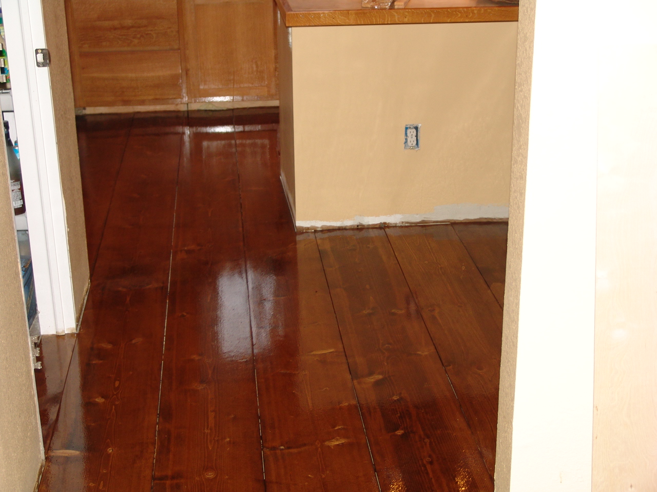

2nd Coat of Poly just went down..
2nd Coat of Polyurethane
floor finishing 2nd coat 002.JPG (545.78 KiB) Viewed 2321 times
