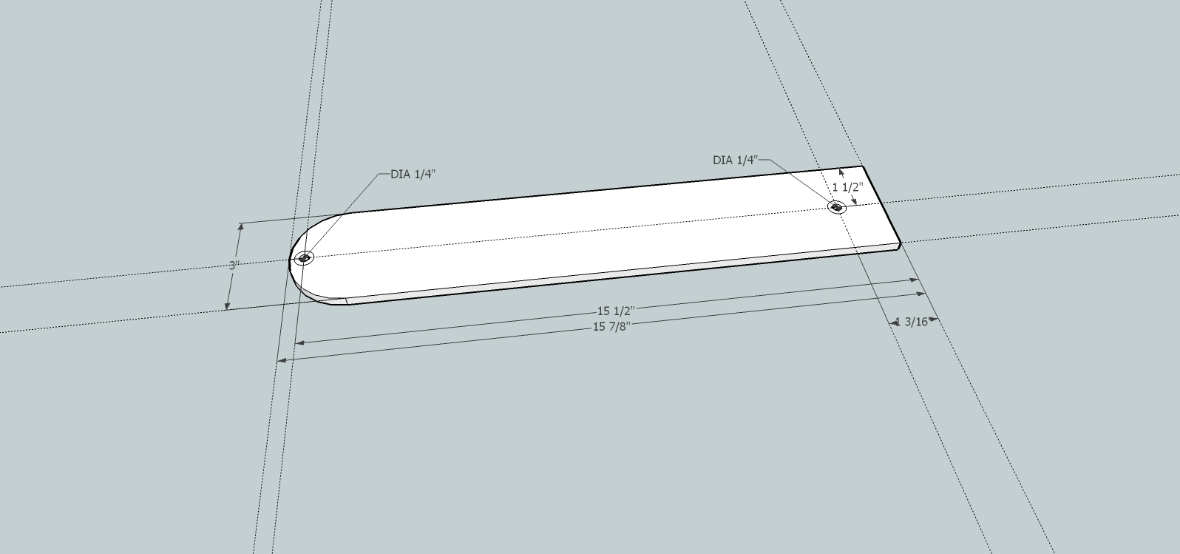

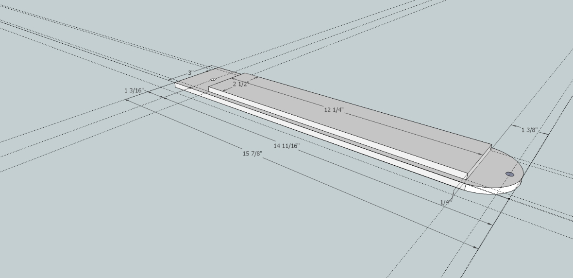

I don't believe so (I don't have a 500) but making inserts for the 510 should be a fun weekend undertaking.Dave H. (CO) wrote:I have a lot of table inserts for a Model 500 table. I have no inserts beyond the standard Mark 510 table insert. Is there a way to modify the Model 500 inserts to fit a Model 510 table?
