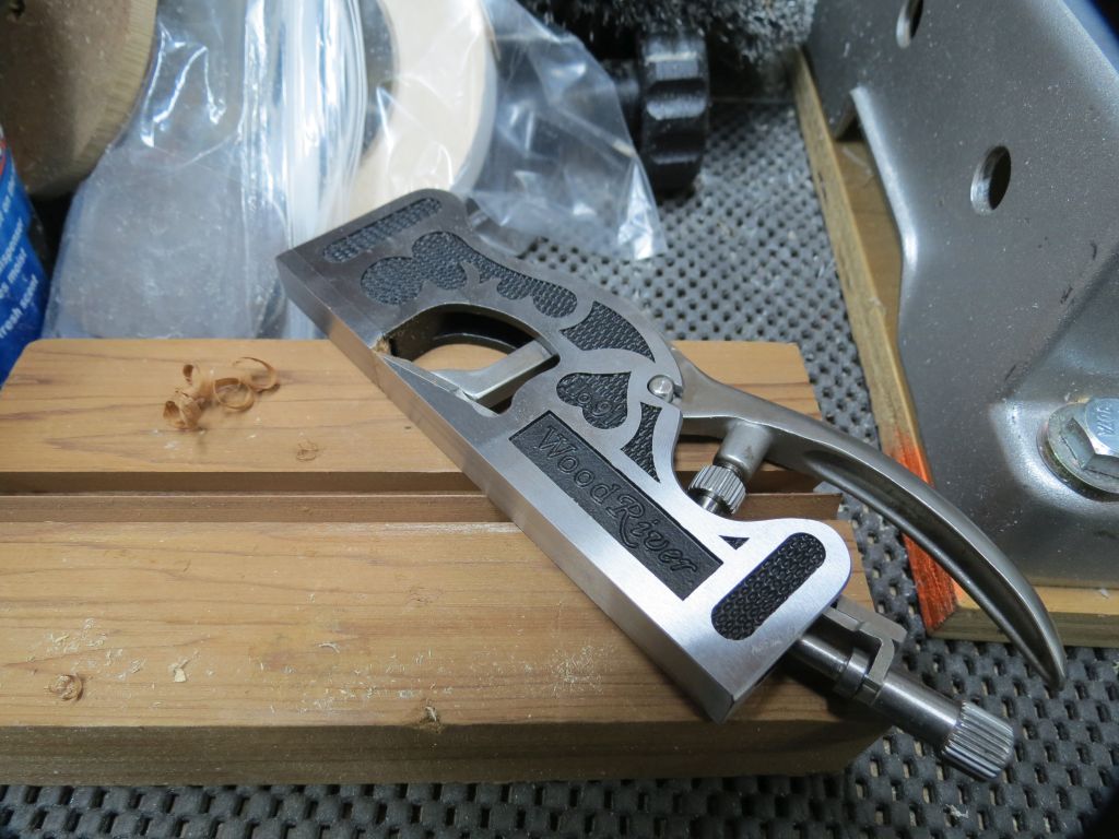

I know you love pictures so lets start with a picture of the plane.

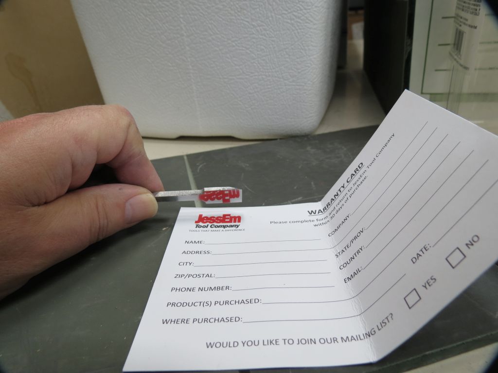

They come with the angle established but that is about it. I guess if one were desperate you could use them in that state but they really need some care out of the box.

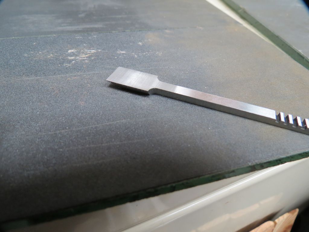

I use sandpaper attached to optically flat glass so I started on the back side and just did a small amount of effort to see how bad things looked. It needed some work, this is a picture of that but it is not clear enough to see what I saw.
I went to the 240 grit and started there as that seem to match what the surface looked like from the company. I then worked to 600 which is when I took this picture.

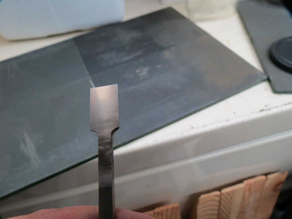

It is pretty flat at this point so I went on to the finer papers and got to 2000 grit where I stopped. Here is a picture of that.

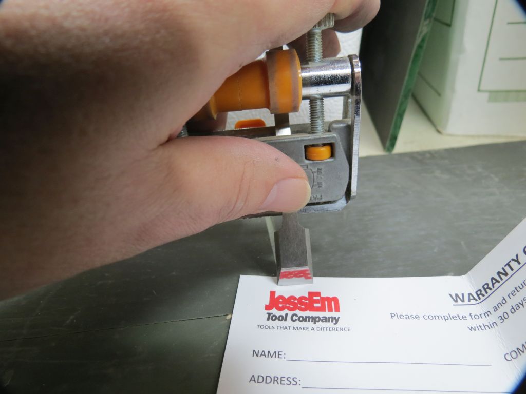

Now I went to the angle and duplicated the angle they had and polished it so it looked like this:
