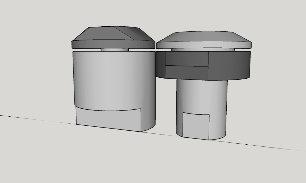

JPG wrote:The reason for the 1 1/4" arbor nut being on the 'inside' is to minimize the extent of the arbor beyond the slot(think trunion interference). Now that incurred the extra cost of having to make it with a left handed thread.
I don't think it is trunion interference. The 5/8" arbor actually extends past the blade more than the 1 1/4" arbor. In the picture the 5/8" arbor is on the left. You can clearly see the 5/8" arbor is longer past the blade than the 1 1/4" arbor. It is in fact 3/16" longer. The 1 1/4" arbor extends past the blade 11/32". The 5/8" arbor extends past the blade 17/32".
Notice that at some point SS Changed the 5/8" arbor. The arbor body on mine is much larger in diameter than the one Paul has. I have 3 or 4 and they are all the same. They were bought in the mid to late 90's and are the same as what is being sold today. My guess is that Paul's is the original version. Another thing, if you look at Paul's 510 arbors, the blades do not register the same distance from the left end of the arbor by about the width of the blade. That is assuming the spindle holes are the same depth which I would think they should be. That dimension should be a (one) standard from which other dimensions are derived depending on the purpose of the arbor.

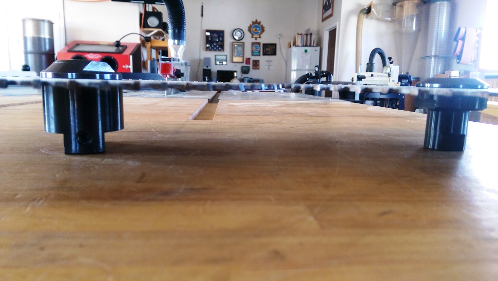

This was something to keep me out of the shop for a while.
I show a 3/32" gap for the blades.
I don't understand the reason for all the mass in the 5/8" arbor.
The bore in my 5/8" arbor is 1 9/32" measured at the wall of the bore.. It is not flat bottomed
