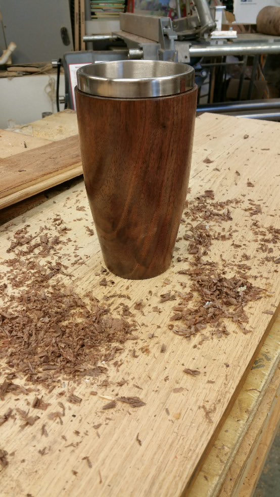

I ended up getting an Irwin bit at Lowes. 2 9/16. It has three blades and a removable pilot screw. seems to do the trick
2016-03-07 18.15.08.jpg (148.13 KiB) Viewed 5490 times
ERLover
Posts: 3914
Re: Large diameter forstner bits
Post by ERLover »
Very Nice Looking!!!!!! :D
