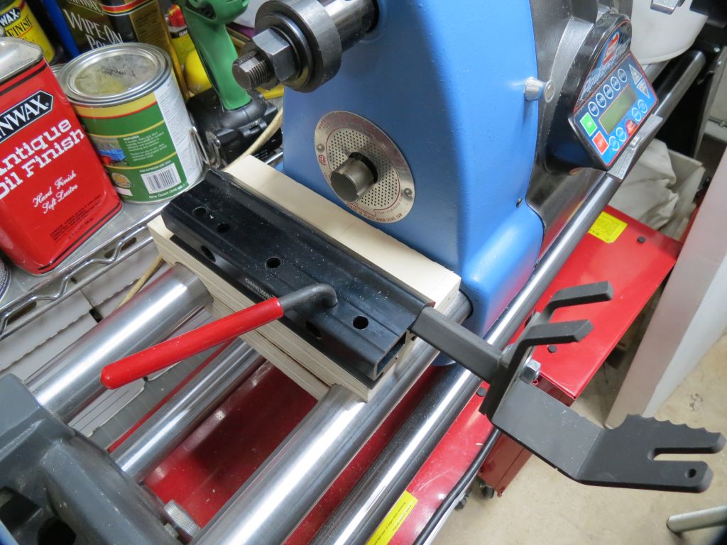

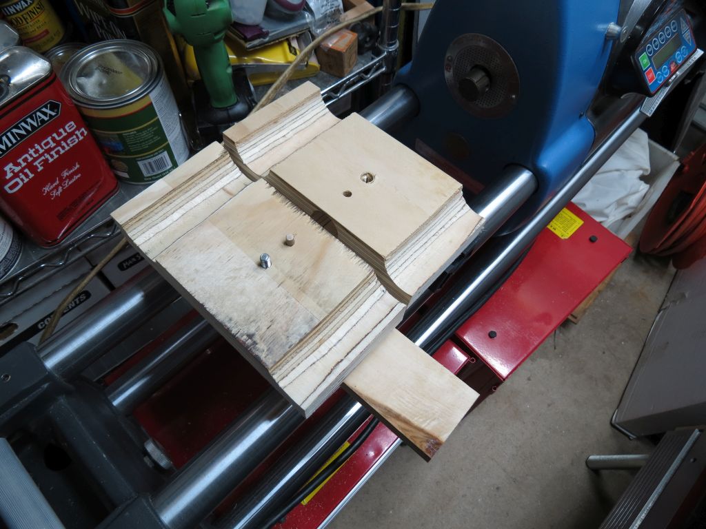

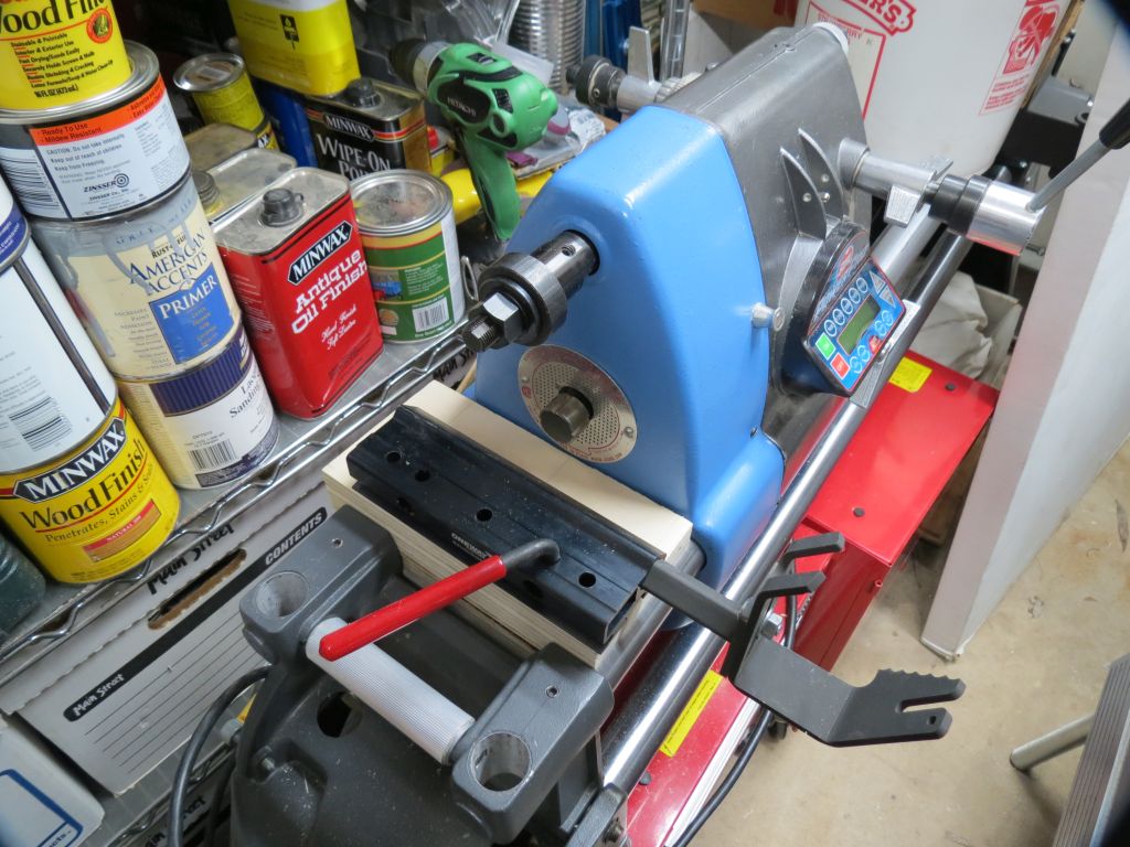

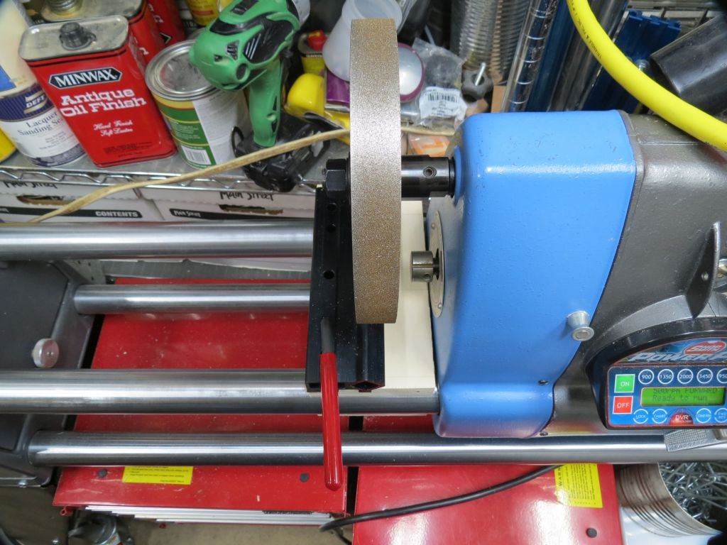

So while I still am waiting on my CBN wheel (it is on order) I went ahead and explored how one might mount this jig on the shopsmiths left end. As we all know having a sharpener to touch up tools while turning is nice.... well unless you are using carbide tools.
Now I don't have an issue with using my grinder or even setting up a second shopsmith for this duty but just because I'm interested I went ahead and built a holder for the possibility of using it as shown.
This would be fine for doing things like pens or bowls but for longer turning you will always have to loose some length due to having this mounted. This is what it looks like when slid all the way to the left. Again this was done without the wheel so it might take a bit more room then shown to center the wheel over the jig.
They have a couple of dimensions that they want, one is to have the shaft center to the base of their jig at between 6-1/2" and 6-1/4" in the vertical direction. This design uses 6-1/2. They also want a certain distance from the center line of the wheel to the front of the mounting jig in the horizontal direction. I'm not sure why that is but I did the design to meet that number.
It is made as a single glue up of plywood then drilled and finally ripped into a top and bottom half. A single screw clamps it to the tubes and allows the positioning that is required. When the wheel arrives I will have a better idea of how this will work.
I have a plan to add a wide dowel that will touch the headstock to position the jig under the wheel but I'll wait until the CBN wheel arrived and I can check out how that might work.
So for now this is done.

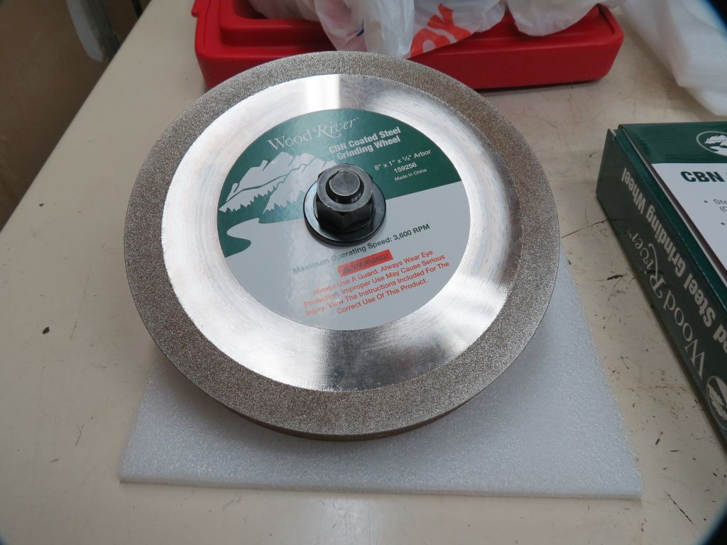

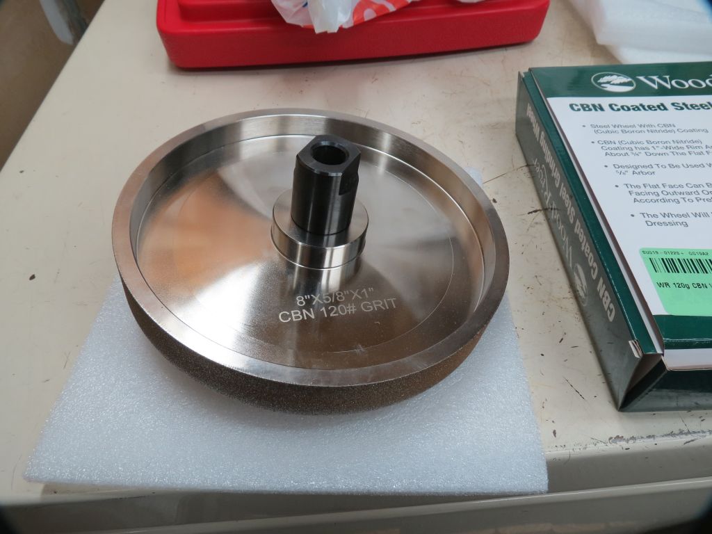

My new CBN wheel is here.
I got a call that my grinding wheel had arrived so I went and picked it up yesterday. This was my first actual look at one up close and personal.
The first think I noticed was how heavy it was. I didn't get a scale out but it has to be at least 5 pounds.
I know this maybe new to a lot of you, especially people who don't turn, but I'm not going to inundate you with facts and flash but just give you a few details and then if it catches your interest go to the web and find some experts inform you.
First CBN is Cubic Boron Nitride, yea its easier to say and to write CBN. They are unlike normal grinding wheels because they are a steel wheel and the coating is put on electroplating. You have a wheel that never need dressing and they are just about perfectly balanced. They don't explode so that worry is gone and they don't give off all that grinding dust like a normal grind wheel does.
The one I got is from Woodcraft and they retail for about $150 but if you wait for a sale you can get them cheaper which is what I did. The prices for these run a pretty good range and this is on the bottom side.
It is 1" wide and has a 3/4" strip on the flat side. Regular grinding wheel should never have the side used for grinding, there are special wheels designed for this but normal ones are not. Think of sharpening drill bits or the likes. It is 8" in diameter and will stay that way.
From what I have heard the steel wheel works like a heat sink so it is very hard to get tools hot. There are less sparks because you are not loosing part of the wheel when sharpening. You can get a good edge with minimal effort and by taking off less metal from your tools.
This one mounts on a 5/8" shaft so that eliminates having to find bushings to get it to fit. It seems to be a nice fit on the 5/8" universal arbor.
Now you can wreck these so keep that in mind I plan to use it for tool steel lathe chisels only.
I'm playing with this idea of using it on the shopsmith but I may actally find a home for it on my 8" variable speed grinder at some point. Right now I'm just playing with it because I still haven't spent the money for new lathe chisels. Figured it was better to get a sharpener before I get the tools so I can sharpen them when I get them.
I did take a couple of pictures.

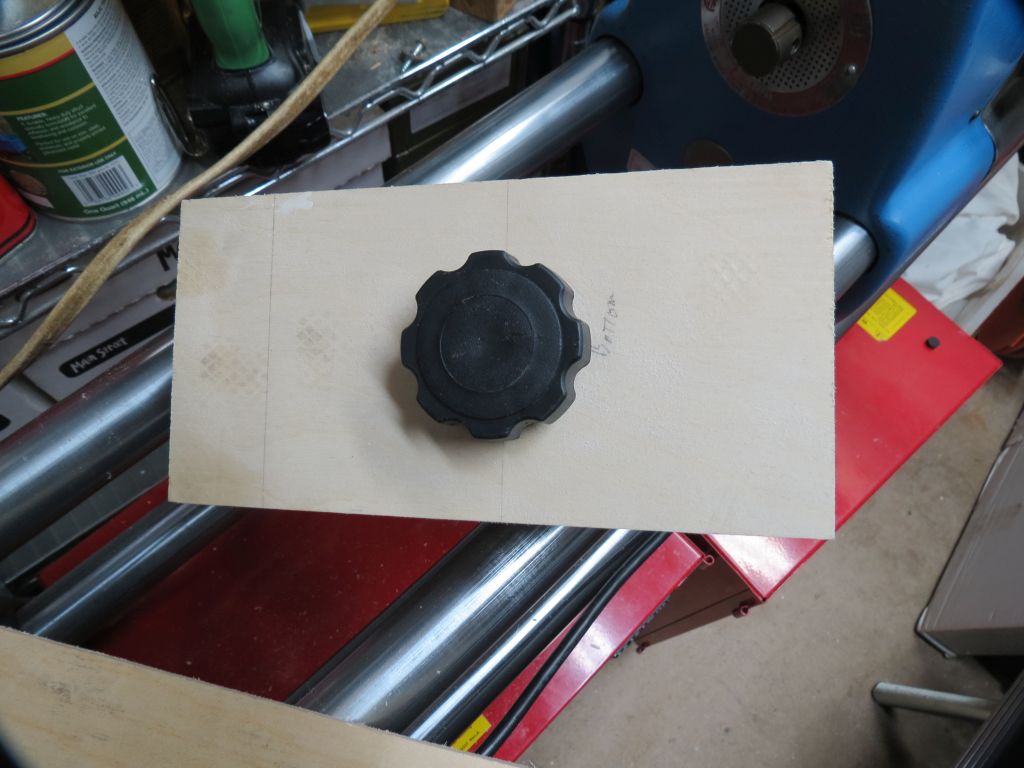

And as you can see here I need to trim a bit off my mount so the wheel is centered on the diamond shape below. It looks like about a 1/4" or so.
This is going on hold for the next while because I have other things that are now stacked above it on my todo list. It will be next month before I can get any lathe tools so there is no rush on the grinder.

Ya Ya Ya, you just wanted to show that Power Pro Control pad off :cool:
Posts: 3815
Re: Woverine tools part 1 and 2 have arrived.
It looks to be a dandy handle for rotating the spindle. And a heck of a flywheel.
What's the max RPM on those? I'm just wondering if you would have to dismount it at higher spindle speeds.
BuckeyeDennis wrote:It looks to be a dandy handle for rotating the spindle. And a heck of a flywheel.
How does 3600 rpm sound, heck one of these would be quite the flywheel......... If it would be necessary to take off it is mounted on an arbor so its just a set screw away.
