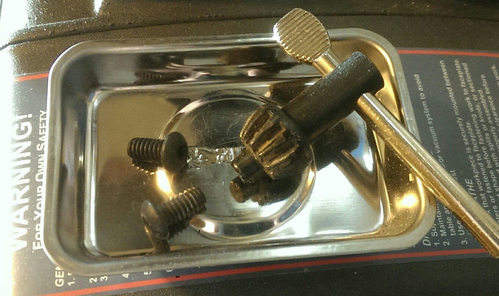

My first mod....hehe. Great thread idea.

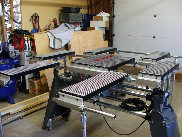

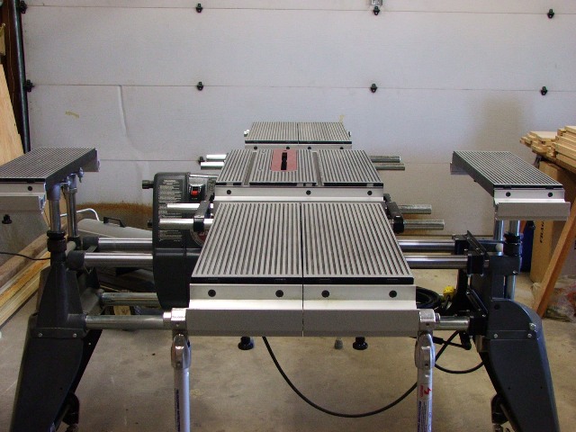

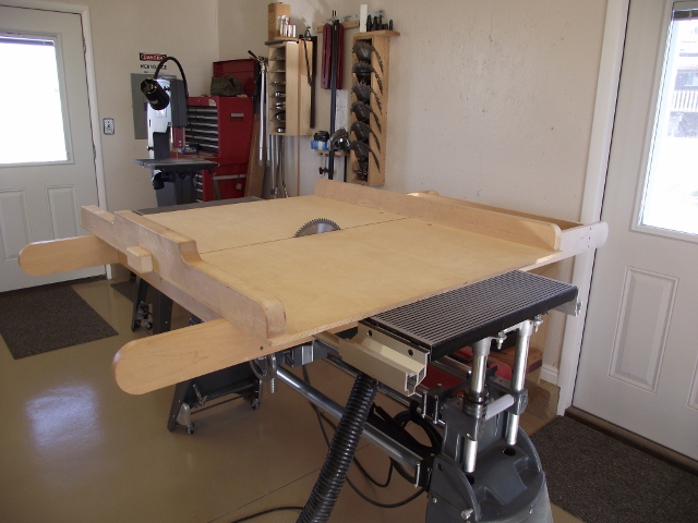

Not to jump on Dusty but IMO there are many options.I use SS parts (not the out feed table they sell) here. The mods Nick made to the one they sell I would do if I had one. For a cross cut sled, the one that SS sells is fine up to its capacity. I have used one for years. As for homemade cross cut sleds they are just fine also and you can make them as large as you want.silenthope wrote:Dusty, could you recommend the type, i.e. homemade/store bought, that you find to work the best for each?dusty wrote:For all models, it is my opinion that you need to have an outfeed table.
For all models, it is my opinion that you need to have a sliding cross cut sled.
